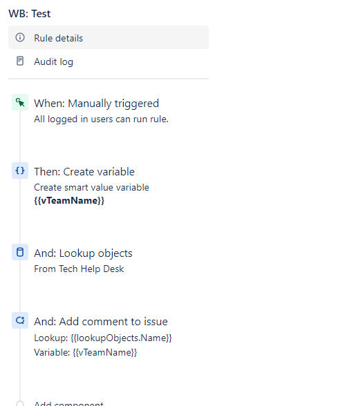

I am hosted so can not export the log.  I split out the automation rule that is not working into a this simple manually triggered automation rule:

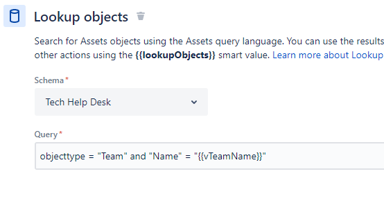

Here's the Query:

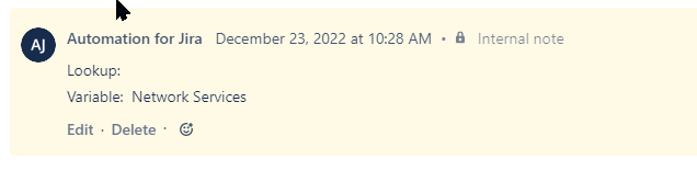

Here's the comment, you can see that the variable printed out "Network Services" while the lookup object returns nothing.

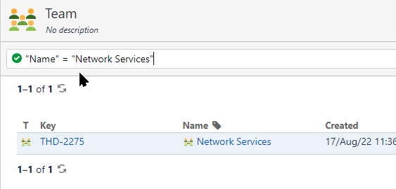

Here's the object it should've returned from the Asset schema:
