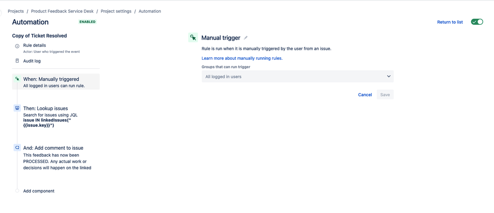

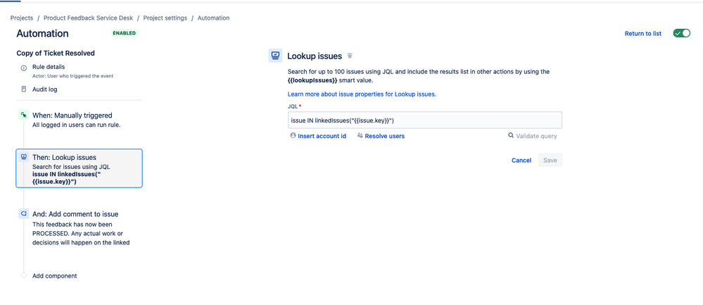

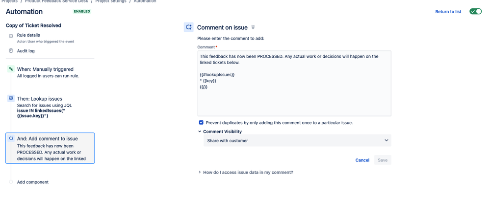

Setup below

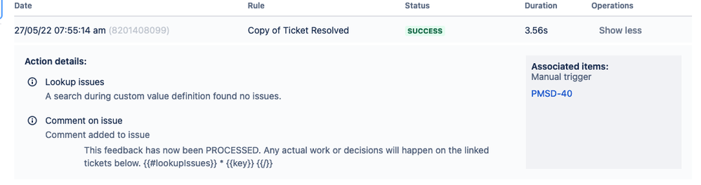

Here is the audit log. Note that it is 'successful' but the lookup fails to find any issues.

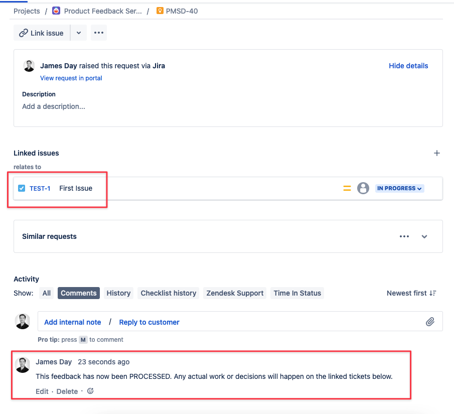

Here is an issue where I've run the automation (relating to the audit log above). Note the existence of a linked issue and the comment is added, but nothing is linked.

IMHO, the problem is in the lookupissues JQL because in the audit log, you can see:
"A search during custom value definition found no issues."
Meaning there are no entries for this JQL query.
