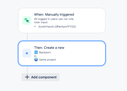

Hi, I am struggling with the automation that is quite straightforward.
I have issue A, the automation starts from the Action button. The popus asks for the fixVersion to be provided and once it is completed the linked issue is created, lets call it issue B.
Here is the automation

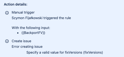

Hi @Bill Sheboy ,
thank you for the suggestion - I did try that already but then the logs looked like this:
Important note that the fixVersion exists in the project so the automation does not create it by itself.

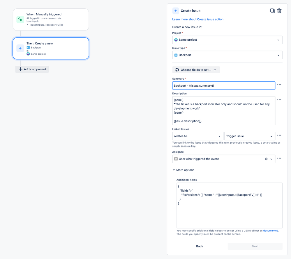

Here is the automation:

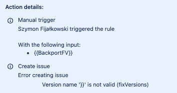

I also made a change in the code based on your suggestion from the post: https://community.atlassian.com/t5/Jira-Software-questions/automation-Add-fix-version-to-existing-fix-version-when-creating/qaq-p/1821136
"update": {
"fixVersions": [
"add": {
"name": "{{userInputs.{{BackportFV}}}}"
 but this also threw an error:

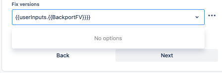

Another one, I saw somewhere that instead of the code I should be able to update the field in the SET option. But the smart value is not visible here:

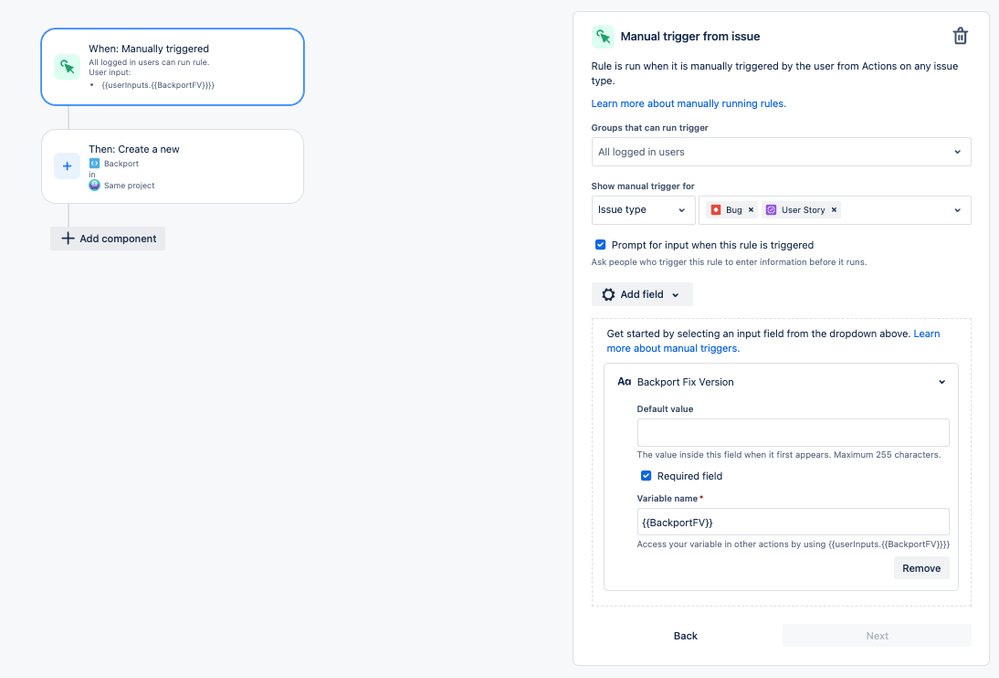

Bill Sheboy
January 10, 2024
Thanks for that information, and I see some extra curly brackets in your smart value expressions which need adjustments.
First in your manual trigger, when defining a variable name, it does not include the brackets.  Please remove those and only use BackportFV for the variable name.  Later when it is referenced, it would include the brackets, like this: {{userInputs.BackportFV}}
And so the JSON needs updates also.  Please try this one to set the value:
"fields": {
"fixVersions": [
{ "name": "{{userInputs.BackportFV}}" }
As the rule is creating a new issue, the update is not used (because the issue does not exist yet).
