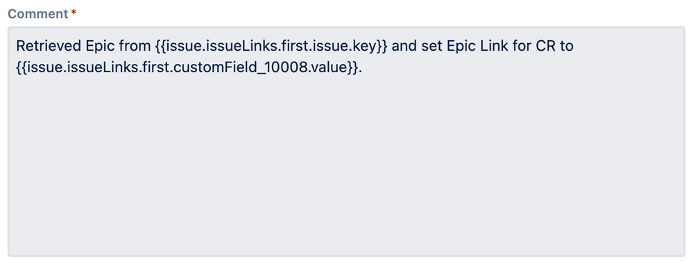

I've added some additional logic to comment on the Issue with some additional values it is able to grab from the linked issue to test the overall concept of issueLinks is working:
Retrieved Epic from {{issue.issueLinks.first.issue.key}} and set Epic Link for CR to {{issue.issueLinks.first.customField_10008.value}}.
This partly works, the issue key is returned correctly but the customField_10008 value is returned as "".  I've tried capturing values from other customFields with the same result.

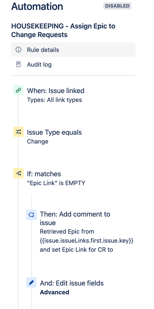

As requested here's a screen of the Automation rule.  Thanks

Mark Segall
September 1, 2022
Thank you for sharing... So one of the important aspects of the issue linked trigger is that you have two parts.  They describe it in the trigger itself:
Rule executes when an issue is linked to another issue. {{issue}} will always refer to the source issue, so if ISSUE-A is blocked by ISSUE-B, this rule will execute on ISSUE-B. To access ISSUE-A, use {{destinationIssue}}, and to access the link type, use {{linkType}} (e.g. {{linkType}}
So, it may be a matter of using {{destinationIssue}}

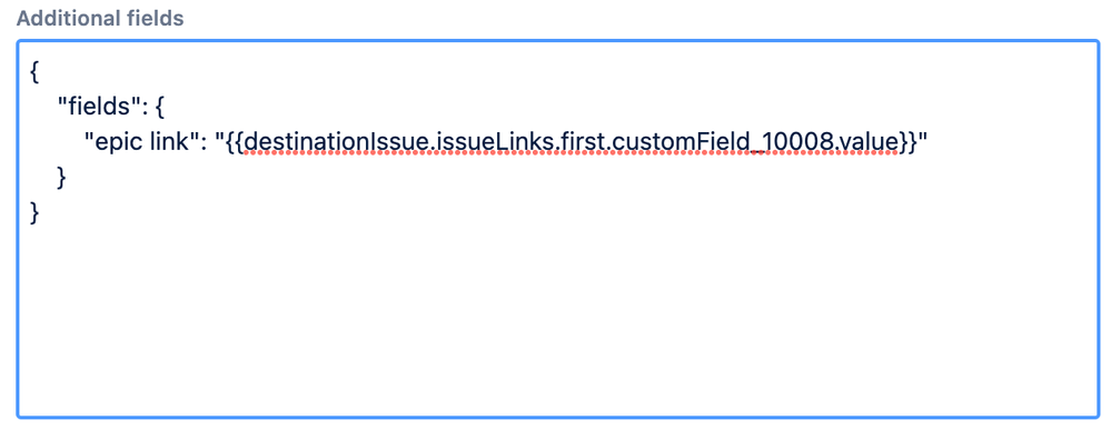

Patrick Booth
September 2, 2022
@Mark Segall
I had a quick look at using destinationIssue as you suggested but Jira returns invalid JSON as indicated by the red underlining in the editor.  Maybe I've misunderstood how it should be implemented?

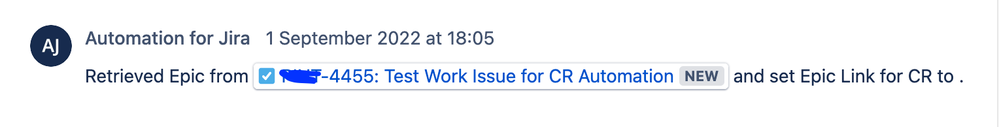

Result:
As you can see it's returning the issue key, this is the correct one and what is expected, however, the value for the Custom Field is coming back as an empty string.  The same applies for other attributes such as name or ID, and with other Custom Fields.

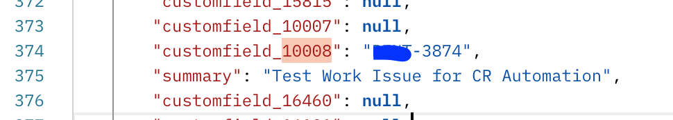

Note:  The custom field reference is correct and the Epic Link Issue Key is populated in the Linked Issue XXXX-4455.  Verified via an API request from Postman:
