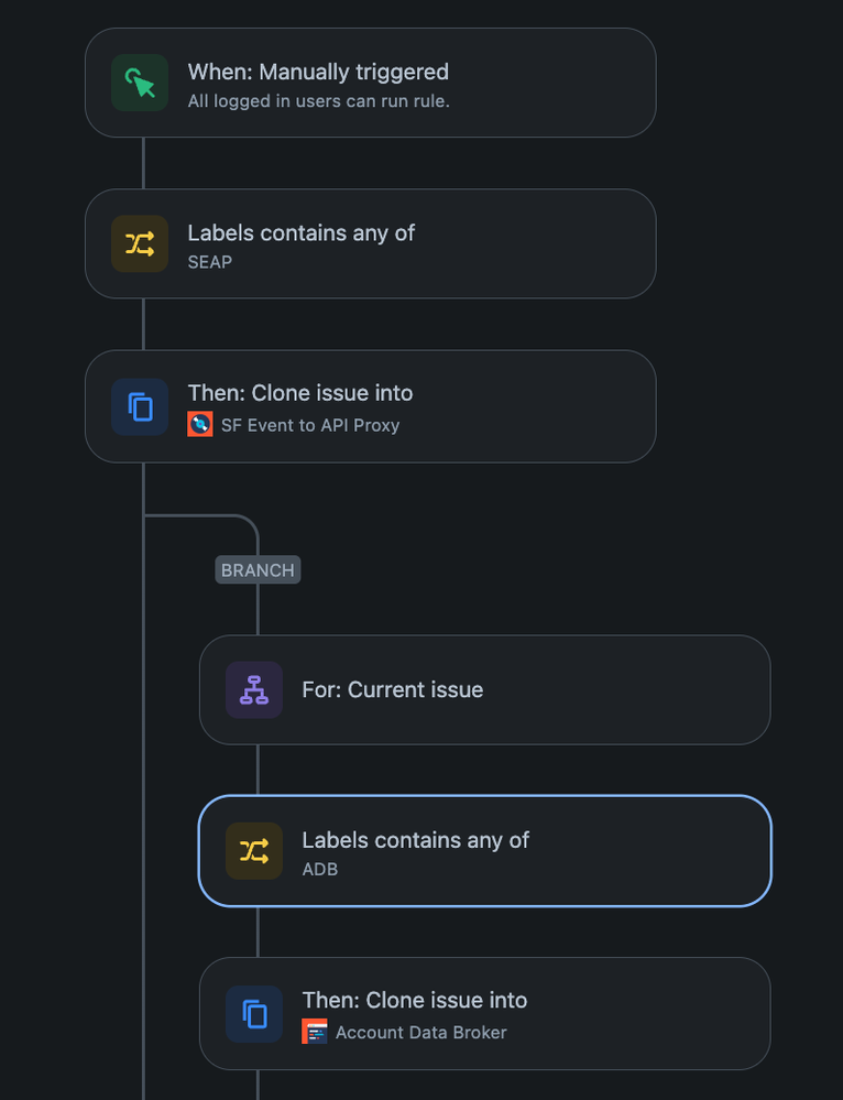

Okay, i feel closer but not quite.
The first automation works great. In my template issue I add the label SEAP and it will clone the issue into the appropriate project. However, my branching doesn't seem to work. If i add the label ADB instead of SEAP, the audit log says "No Actions Performed". Probably i don't understand how branching works.
Any thoughts?
So looks like this:

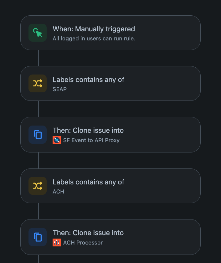

Josh Allen
May 16, 2024
I also tried this but same result, no action performed.
Bill Sheboy
May 16, 2024
Are you trying to check for label values of SEAP or ACH?
If so, I believe your rule needs a different structure so it does not halt after the first condition test:
  • trigger: manual
  • branch: to current issue
    • condition: labels contains SEAP
    • action: clone issue...into "SF Event to API Proxy"
    • condition: labels contains ACH
    • action: clone issue...into "ACH Processor"
This allows each branch to proceed and the conditions to succeed or fail without impacting the others.
Josh Allen
May 16, 2024
YES! Thank you. That was it.
The only thing, or most simple thing, i could do was have a template issue, then add the label for the appropriate project, then run the automation so it clones into that project.
This is great. Appreciate the help.
