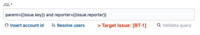

I like your idea, but I think it'd be better if they just updated the existing "Validate query" functionality they already have for JQL fields.
They've added things like "Insert account id" and "Resolve users". What they need is to add your suggested "Target Issue" here:
And then yeah, once that is set, it should populate any smart values from that issue when you click Validate query (which is currently grayed out because of the smart values.

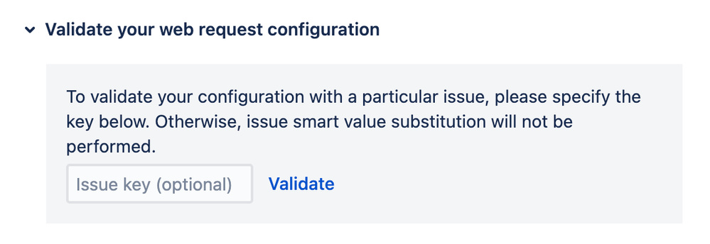

Oh hey so tonight I was reading @Esther Strom's excellent article on Automating the creation of a Confluence page linked to a Jira ticket and noticed something about the Send Web Request action:
It includes a validator! So Atlassian already has some code in Automations that is able to lookup an arbitrary Jira issue and use that to populate smart values:
