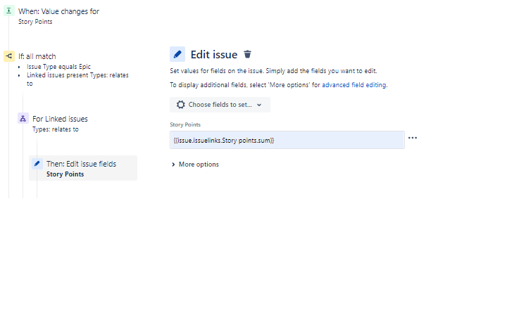

I need to update the story point of an "Initiative" as the sum of the "linked" epics. So epics are linked to the initiative (not as a subtask but as a link). Whenever the story point of the epics change, the change should get reflected in the way that the sum of story points of all the linked epics should be = story point of the initiative
1.  When: the value of story points changes
2. If the issue type is epic and there are linked issues
3. For the linked issues (which means the for initiative}
Story point  = {{issue.issuelinks.Story Point.sum}}
However, this is not working. The story point for the initiative is zero even when the story point for epic has values

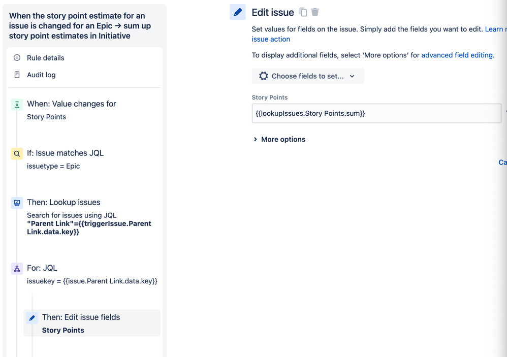

Jordan Richter
October 17, 2023

Apoorva Pahuja
November 30, 2021
There are no errors, the rule is successful, but the sum is not happening, the story point value is 0
See rule below:

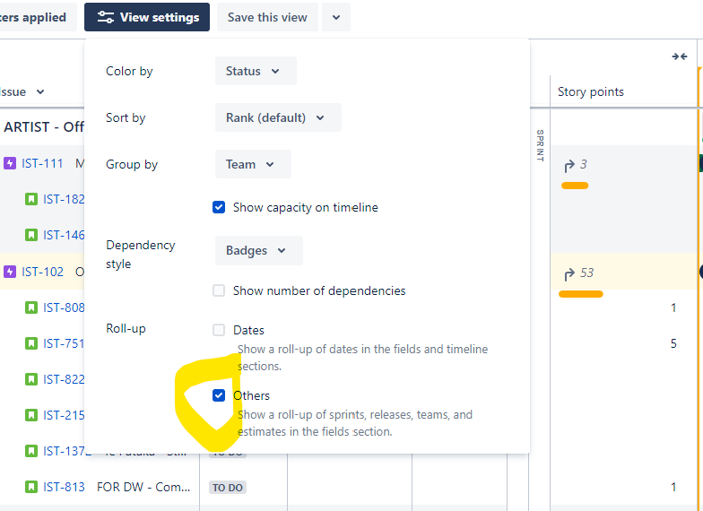

Are you talking about "parent link" (I.E. the epics that are children of the initiative) or just standard JIRA "linked issues"?
As, using the "Parent link" field with an Advanced Roadmap plan and Story points "rolled-up" feature enabled means you can get the affect of "summing", without the need to automate at all.
See below "Roll-up" checkbox to tick and Story points column with "rolled-up" story points from the children (denoted by the up arrow)

Thanks for the image of your rule.  I believe that {{issue.issuelinks}} only contains the keys and not the rest of the data (such as story points).  You could confirm this by writing the following to the log in that branch to learn if any values are shown:
{{#issue.issuelinks}} {{Story points}} {{/}}
And even if that did work, your branch's scope would be updating the story points of the epics.  You would then need to accumulate the values for the epics to store a total in the initiative.

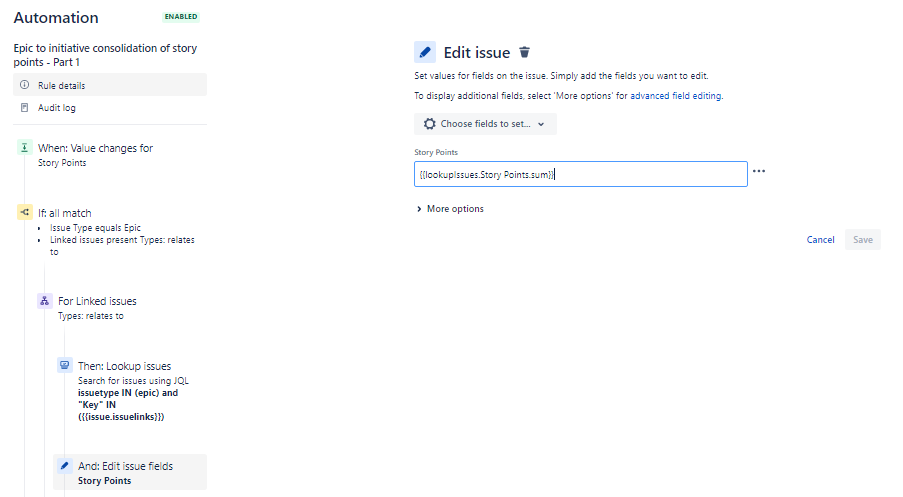

Bill Sheboy
December 2, 2021
Thanks for that information.  That means the issue links only contain the keys, as I suggested.  To sum up the story points for linked issues you may to use another method, such as Lookup Issues with JQL on the list of issue link keys:
key IN ( {{#issue.issuelinks}} {{key}} {{^last}} , {{/}} {{/}} )
With that for the lookup's JQL, you may get the sum from:
{{lookupIssues.Story points.sum}}

Apoorva Pahuja
December 3, 2021
Thanks, so finally these rules worked.

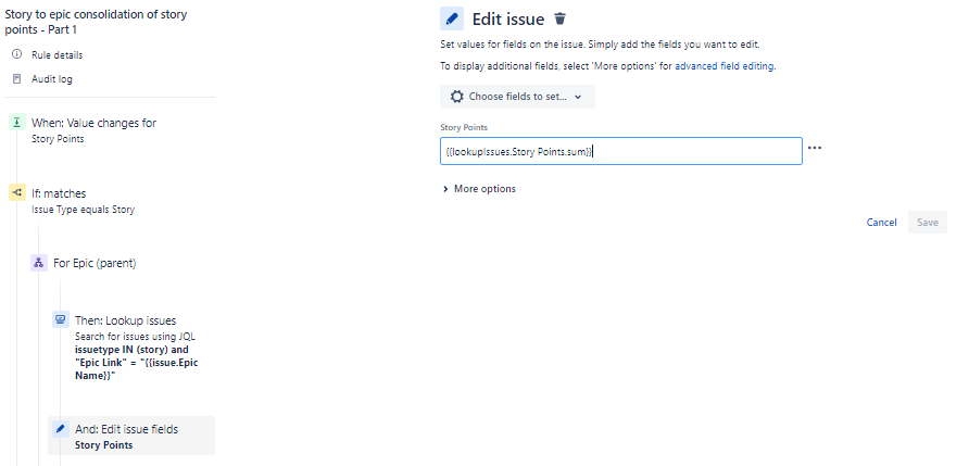

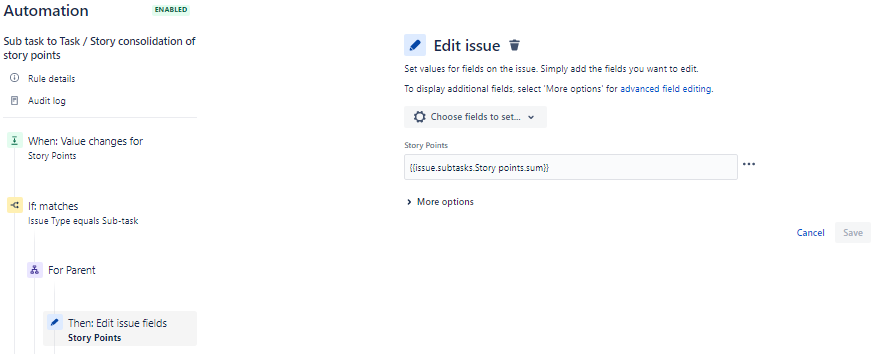

Apoorva Pahuja
December 3, 2021
All the rules are attachedEpics to initiatives.pngStories to epics.pngSubtasks to Stories.png
