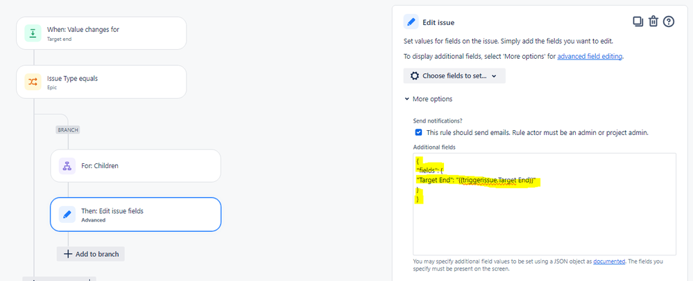

For example: if it is in fact Target End field, you could use below:
"fields": {
"Target End": "{{triggerissue.Target End}}"
OTOH, if you want to sync it to Due Date, you would use below:
"fields": {
"Due Date": "{{triggerissue.Target End}}"
BTW, as you can see, you dont need the variable before branch to store the date, you can directly reference the epic's target date like above..
I have attached a screenshot of how it should look like, please try and let us know if issues. Please share screenshots of your rule and audit log if some thing does not work so we can help.
Kristi Shaw
February 26, 2024
This worked perfectly, thank you!
