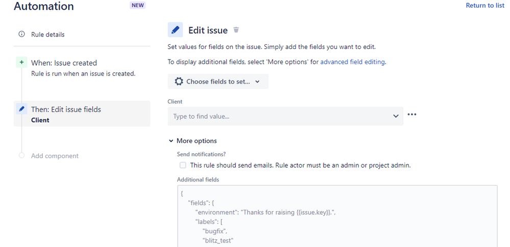

Thanks - I am using JIRA Cloud.
I am having trouble figuring out WHERE to extract the domain and use the if/else condition.
If I go into my Project's Automation Settings and select Create Rule and create a rule for then the Reporter gets updated, I don't see a place where I can parse the domain and create the if/else statement.
Or... even better, I have no idea on how to make a lookup table and parse from there (but will do some digging into how to do that).
Either option would work  - I just have to figure out how to do it.
