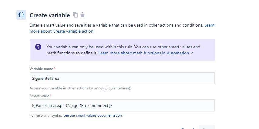

Adolfo Casari
October 11, 2023
@Bill Sheboy  the whole rule is too long, but here is the issue:
1) I create a variable and log its value (I get 1)
2) I use it to get the next item in the list.
Log SiguienteTarea and get nothing.
If you put get({{ProximoIndex}}) get an error. If you put get(1) you get the next element. Tried also ProximoIndex.asNumber with no luck.
Bill Sheboy
October 11, 2023
The get() function for a list can only take a number for a parameter.  It cannot take a smart value, either from a field or from a created variable.
If you review my earlier posts, I described how to perform this type of search using a match() function and a dynamic search expresssion.
When your rule is longer, you can try using either a screen capture or a browser addon which can scroll to grab the entire image.
