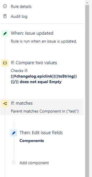

  1. When an issue is updated
  2. And If that update is the Epic Link being created
  3. And if the Parent matches “component in (“test”)
  4. Then Edit Issue add Component value(s) you want.
I would like to create an automation for when a story is tagged with a certain epic link, then a certain component is automatically added. I know this is close, but the automation still isn't working.
Can anyone give me some guidance on this?

Hi @Alyssa White and welcome to the community!
I'd recommend something like this:
  • TRIGGER: Field Value Changed (Epic Link)
    This is less noisy than Issue Updated
  • CONDITION: Epic Link Is not Empty
  • IF CONDITION (Related Issues Condition)
    • Epic
    • Matches Specified JQL
    • Component IN (Test)
    • ACTION: Edit Issue Fields (Component)
Alyssa White
June 15, 2023
Thanks so much @Mark Segall  this works great!!
