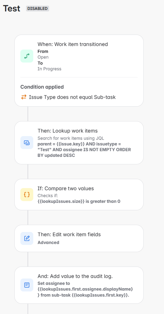

Hi @Jerry Rodriguez , assuming you are using Jira cloud, this set up of a single automation rule should work for you:
  • Project settings → Automation → Create rule.
  • Trigger: Issue transitioned
    From status: In Progress
    To status: QA
  • (Optional) Ensure this only runs on parent issues:
    Issue fields condition → Issue type is not Sub-task
  • Find the Test sub-task under the parent
    Lookup issues with JQL:
    parent = {{issue.key}} AND issuetype = "Test" AND assignee IS NOT EMPTY ORDER BY updated DESC
(Adjust the issue type name if your Test sub-task is called something else.)
  • Only proceed if one exists
    Advanced compare condition
    First value: {{lookupIssues.size}}
    Condition: greater than
    Second value: 0
  • Copy the assignee to the parent
    Edit issue (this edits the current/parent issue) → open More options (JSON) and use:
    {"fields": {
    "assignee": {
    "id": "{{lookupIssues.assignee.accountId}}"
(Nice to have) Add a comment or an Audit Log action:
Set assignee to {{lookupIssues.assignee.displayName}}
from sub-task {{lookupIssues.key}}.
