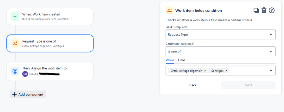

Hi, I do have a team managed Jira Service Management project and wanted to make an automation rule which assigns a created work item to a specific user, based on the request type.

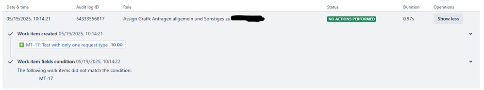

But the rule is not run successfully, I always receive the info that "the work item did not match the condition"

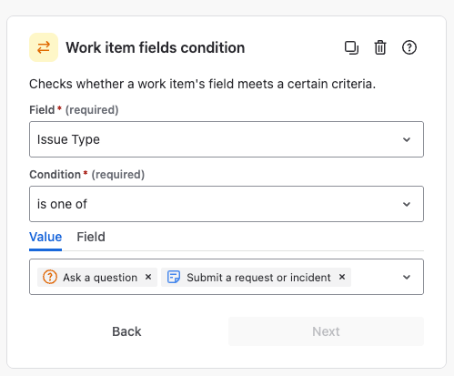

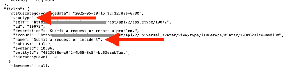

I discovered that with a Team Managed Service Management project you need to use Issue Type rather than Request Type.
In Company Managed Service Management project the items have both "issue type" and "request type", and the latter are associated to the former.
In Team Managed JSM projects when you are in Project Settings they show only "Request Types" and there is no requirement for both Request Types and Issue Types, as in CM JSM projects.
However it is a fundamental requirement of Jira that all work items have a value for "issue type".
I used the information here to output all the fields associated with a TM JSM issue. I found that the "request type" value was stored in the field named "issuetype"

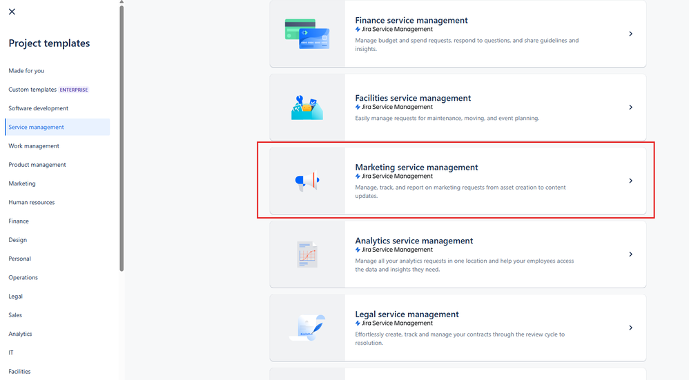

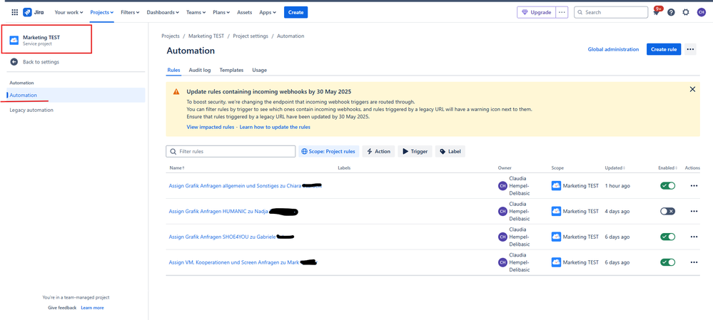

Hi @Julia Watson-Clarke , thanks for your reply! I created the automation directly in my Jira service Manamgent project "Marketing TEST". For the creation of the project I used the template Service Management - Marketing service management.

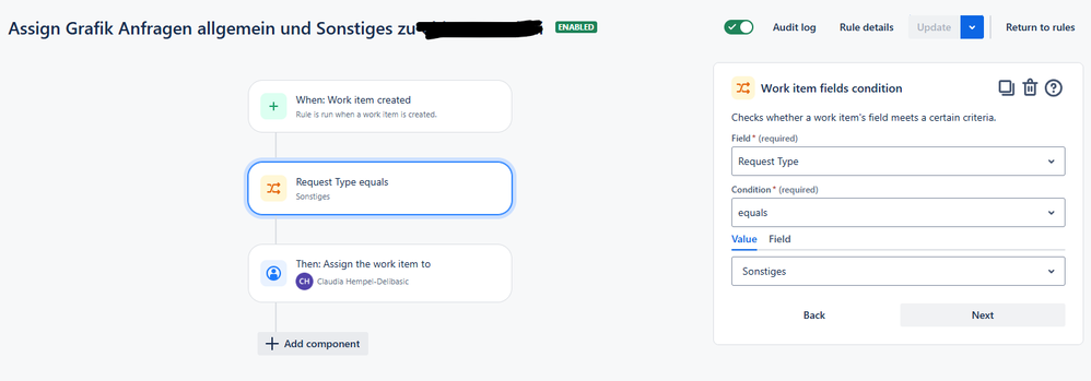

I updated the rule and only added one request type:
But I received the same error message in the audit log:

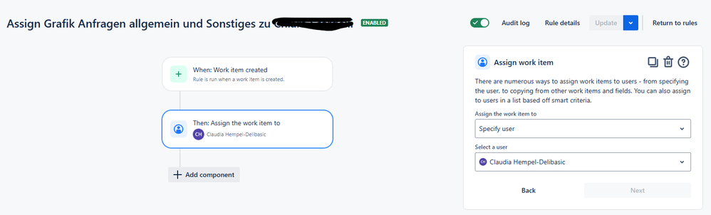

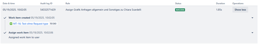

And then I tried to remove the condition regarding the request type, and then the automation did work and automatically assigned the ticket.
So it seems that it really has something to do with the request type, but I don't know what is wrong there?

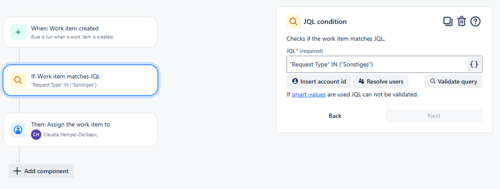

claudia.hempel-delibasic
May 20, 2025

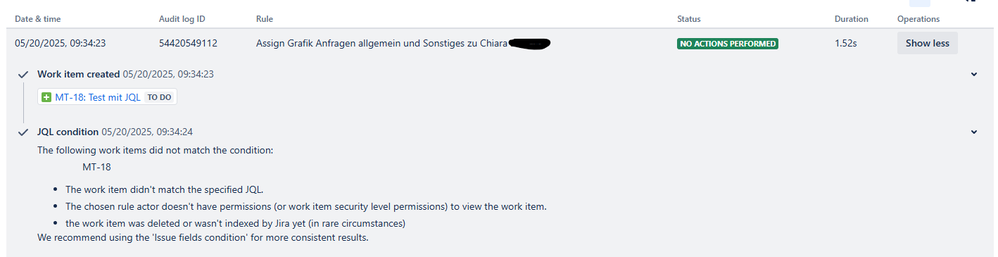

Hi @Valerie Knapp , I tried it with the JQL, but unfortunately it didn't work. But I'm not sure if I used the correct JQL ->
"Request Type" IN ("Sonstiges")
This message I did get in the audit log.
