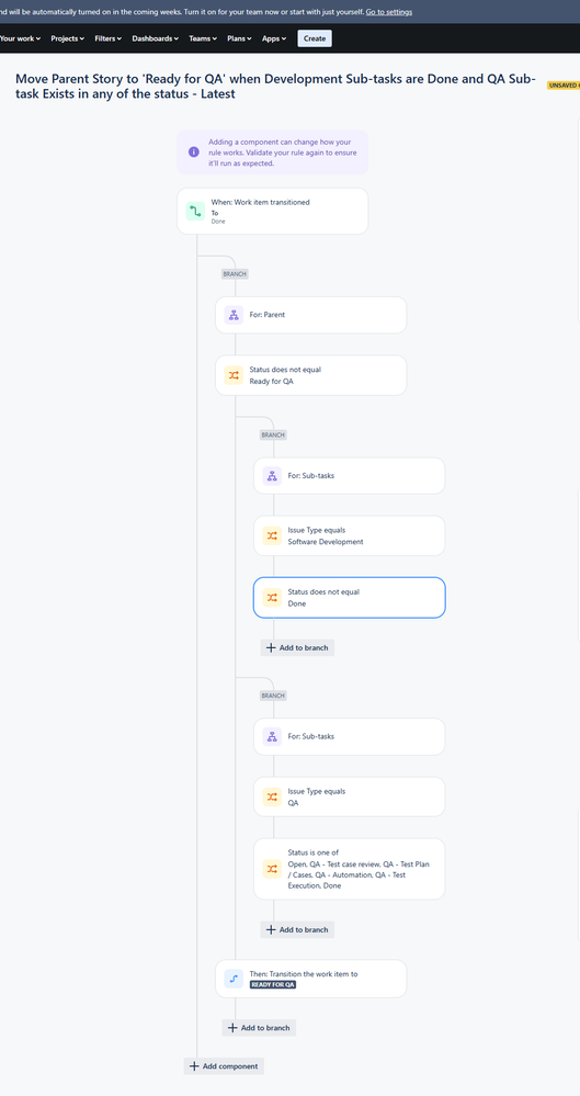

Hi @Trudy Claspill ,
Thank you for the response. I create rule for the below condition,
Move Parent Story to 'Ready for QA' when all the Development Sub-tasks are Done and QA Sub-task Exists in any of the status.
Please find the attached screenshot for reference.

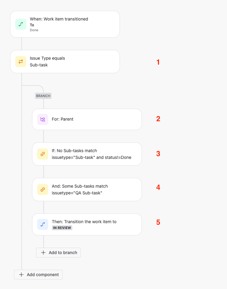

I believe this is the rule you need:
  1. First confirm that the issue triggering the rule was a Dev Sub-task.
  2. Branch to the sub-task's parent
  3. This will confirm that there are not any Dev Sub-tasks set to any status other than Done
  4. This will confirm that there are some QA Sub-tasks under this parent issue.
  5. If both 3 and 4 are true, then transition the parent issue to the desired status.
If either 1, 3, or 4 are not true, then none of the steps that come after the not-true condition will execute and the Parent issue status will not be changed.

Something is curious about the rule image you show: there is no such feature as nested branches in Jira Cloud, Server, or Data Center at this time, but your image shows nested branching.
There was a defect that allowed dragging a branch inside of another one while editing a rule, and that produced undefined / unpredictable behavior until it was fixed (for Jira Cloud).
Please explain how you created that rule, and if it is indeed an Atlassian Automation rule image.
