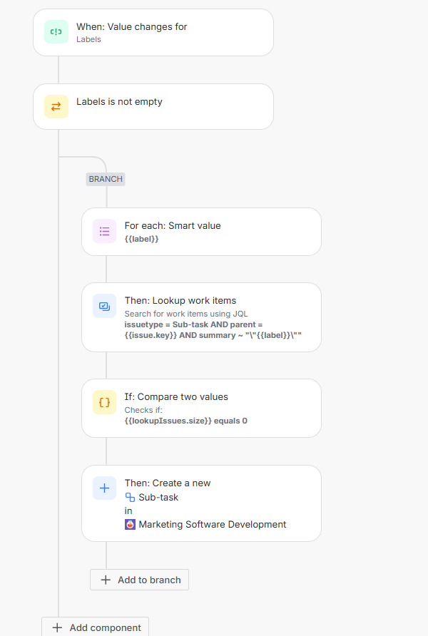

Hi all, I have a dropdown list, for each option chosen I want to create its own subtask. The thing is I don't want it so that if you choose 2 options 2 subtasks get created, then you choose a third option and then 3 subtasks get created making a total of 5.
I use a trigger of "issue field added", but I can't for the life of me figure out how to get those details into an automation.
In particular I tried to use a for-each branch to branch over the {{to}} values but it doesn't seem to run through each one. I'd like the subtask to have the name of the option chosen as well.
Thanks!
Christos Markoulatos
October 14, 2025
Hey @Calvin
try something like this:
Hope this helps!
Calvin
October 14, 2025
Thank you it helped a lot, I was finally able to get the value.to and value.from working which is great, but it was the branch that was throwing me for a loop (hehe). Using just {{value}} however worked perfectly :D, thanks!
