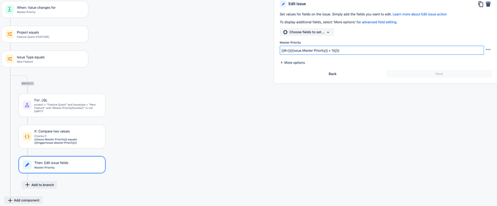

I'm trying to create an automation for the following scenario, but I'm stuck and need help.
Step 1: tickets are assigned a numeric "master priority" (custom field)
  • Ticket A = master priority 1
  • Ticket B = master priority 2
  • Ticket C = master priority 3
Step 2 - Ticket D is assigned master priority 1, and the other tickets automatically bump down as follows:
  • Ticket D = master priority 1
  • Ticket A = master priority 1 -> 2
  • Ticket B = master priority 2 -> 3
  • Ticket C = master priority 3 -> 4
I tried the automation above, but it only bumps down Ticket A and not the others. The result looks like this:
  • Ticket A = master priority 2

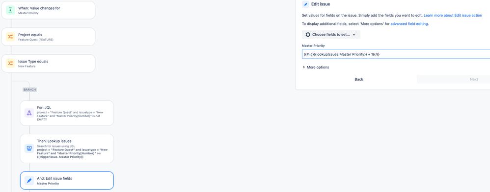

I also tried using a "lookup issues" action, but it didn't work at all.
Help!

Your first idea of using a branch looks correct, and perhaps add to the JQL a condition to only grab issues where their Master Priority is >= the trigger issue value.  That will eliminate the need for the rule condition comparing to the trigger issue's Master Priority.
Some challenges with a rule like this are:
  • Timing, and race-track errors: Branches on more than one thing are executed in parallel and asynchronously.  The only reason this rule might work is because the values are only incremented and it is assumed they already correct.  However...
  • If there is a mistake and the rule triggers again in rapid succession, the behavior will be unpredictable
  • If the rule does not run, due to an automation engine or infrastructure error for Atlassian, the behavior will be unpredictable
  • Branches can only execute on up to 100 things, and so if you are trying to use this solution approach for more issues it will not work

Adding on to the JQL you already have, please try:
AND "Master Priority" >= {{triggerIssue.Master Priority}}
But before you do that, please check a couple of things...
Confirm that field name in JQL, perhaps with a test query outside of the rule in View All Issues.
Next, smart values are name, spacing, and case-sensitive.  And, the smart values sometimes do not match the displayed field name on the Jira issue views.  Please confirm your smart value (or the custom field id) using this how-to article:
https://support.atlassian.com/cloud-automation/docs/find-the-smart-value-for-a-field/
Like • Gerald Oliver likes this
Gerald Oliver
November 3, 2023
This seemed to do the trick. Thanks so much!
