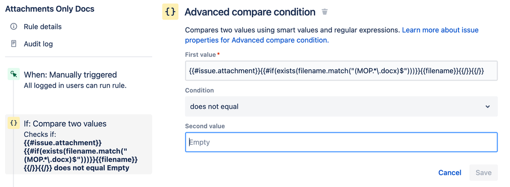

I would also suggest that if you aren't already you should probably do a check to make sure that this smart value:
{{#issue.attachment}}{{#if(exists(filename.match("(.*\.docx)$")))}}{{filename}}{{/}}{{/}}
does not equal Empty. (To ensure that you don't send an email if there are not any docx attachments.)

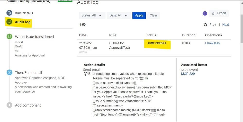

But when i am implementing that, getting below error in Audit log(Project Automation), E-mails notification not receiving . Can you help me out from this.
Note: This is file name : MOP-230_Test_1
Error rendering smart-values when executing this rule:
Tokens must be separated by '.': ”))): Hi {{issue.approver.displayname}}, {{issue.reporter.displayname}} has been submitted MOP for your Approval. Please approve it. Thank you. The issue: <a href="{{issue.url}}">{{issue.key}} - {{issue.summary}}</a> Attachments: <ul> {{#issue.attachment}}{{#if(exists(filename.match(“(MOP\.docx)”)))}}<li><a href="{{content}}">{{filename}}</a></li>{{/}}{{/}} </ul

Hi @Gnana Sekhar Reddy -- thank you for including the error message. It was very helpful in finding the problem.
The thing that was breaking your rule is that your quotation marks in the match block are curly quotes, not "straight" quotes.
I replaced the quotes with straight quotes, and it got rid of the error.
HOWEVER your rule will not work as intended unless you add a wildcard (.*) to your match, so it should be:
match("(MOP.*\.docx)")
Also, as with my advice to @E Hanumanthu you probably want to do a check to ensure that there is an attachment that matches what you expect before sending the email.

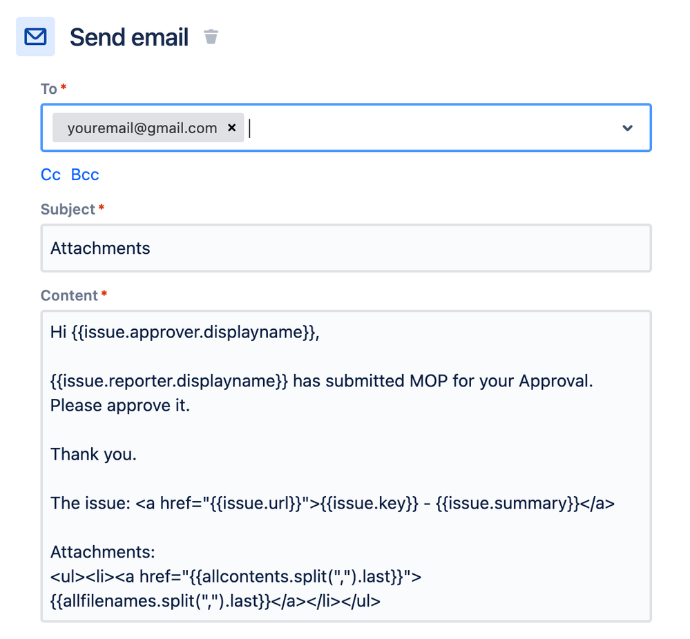

  • Update email to use split function to separate out lists of MOP filenames/contents, then use last function to get the last one.
    <ul><li><a href="{{allcontents.split(",").last}}">{{allfilenames.split(",").last}}</a></li></ul>

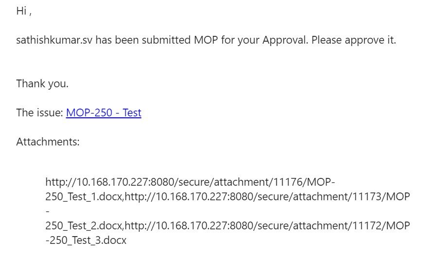

Gnana Sekhar Reddy
January 12, 2023
Hi @Darryl Lee
The above 2  are not working. I am getting all the MOP files/Content links. Can you please looking into it. For your reference i am attaching output also.
1) {{#issue.attachment}}{{#if(exists(filename.match("(MOP.*\.docx)")))}}{{filename}}{{^last}},{{/}}{{/}}{{/}}
2) {{#issue.attachment}}{{#if(exists(filename.match("(MOP.*\.docx)")))}}{{content}}{{^last}},{{/}}{{/}}{{/}}
Even that's not opening format like this below
Email Out put:
Email Output:

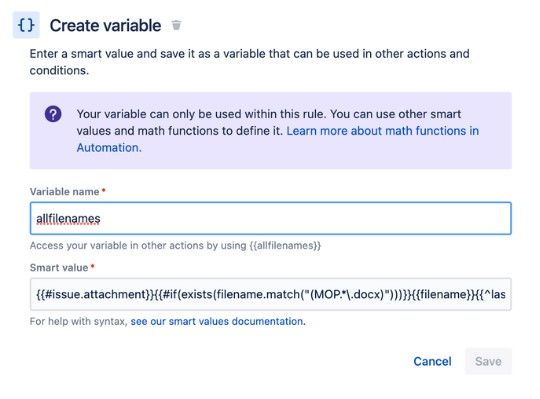

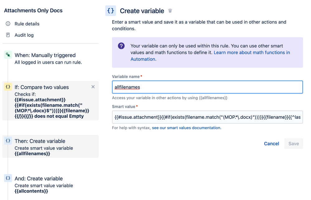

So you need to use the Create variable action to create the variables I mentioned, like so:
Then you will reference those variables in the email, like so:

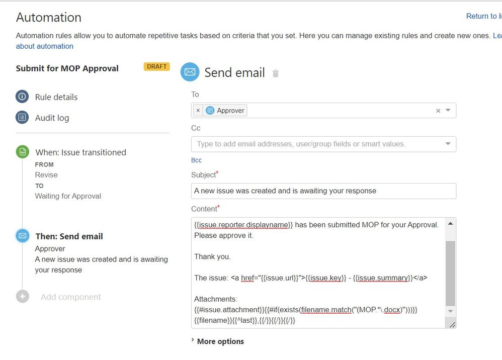

Gnana Sekhar Reddy
January 13, 2023
Hi @Darryl Lee Please find attached Screenshot of my Automation rule.

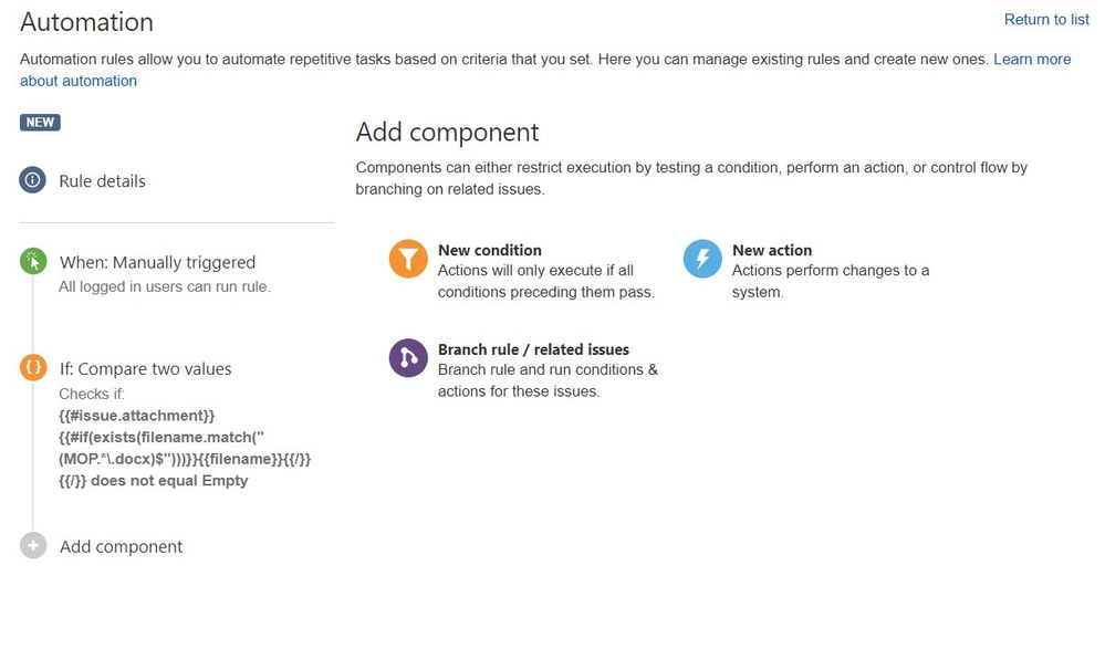

Gnana Sekhar Reddy
January 13, 2023
Hi @Darryl Lee for this below screenshot which new action you took for that( Create Variable).
I struck here. Can you please help me out. I am following your steps only.
Darryl Lee
January 13, 2023
The manual trigger I am using is just for testing.
What you need to do is edit your existing rule and insert the 2 "Create variable" actions after your trigger, and then update the Attachments section of your email to use the code I gave you (that includes the "split" commands).

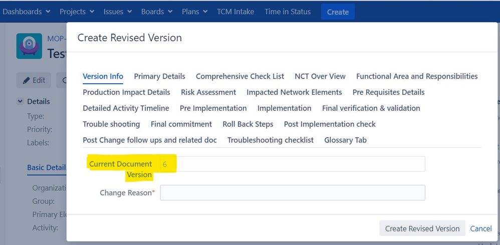

Hi @Darryl Lee is it possible to attach(Implement smart Values) based on Current Document Version of an Jira issue. For your reference find attached screenshot.
If possible means that could be find so we can easily attach latest version document.
Darryl Lee
January 16, 2023
I don't think there's a way to use a field value as part of a match function, so no, I don't think that will work.
