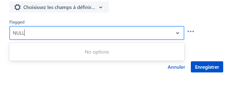

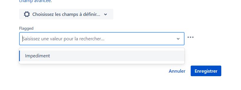

I try but can't , rule doesn't take my 'NULL' writen. I can only choose 'impediment'image.pngNULL is not accepted : image.png
Ste Wright
August 4, 2023
Hi @PARISATO Marie-Hélène
Apologies for confusion, for NULL, just leave the field empty in the automation action :)
Ste
August 4, 2023
no i can't , i try too be sure.

Arkadiusz Inglot
August 4, 2023
Hi
In automation:
Edit issue action > field called: "Flagged" > select your created values
Ignacio Pulgar
August 4, 2023
Just type "Impediment" as the value.
