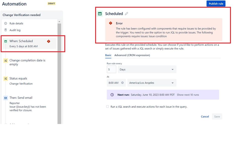

Hi Mikael, I get the following error when trying to publish the automation:  Thanks!

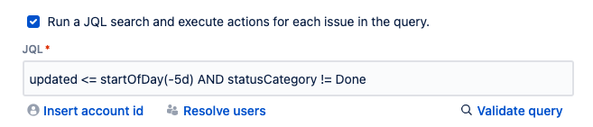

Because you are setting it up as a scheduled rule you also have to check the box for "Run a JQL..." just as in the example I linked to:
And you can add your conditions to the JQL instead of having separate components for it.
