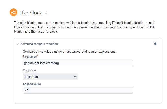

Ok, that with the empty comment was easy. But if I have the following else block, it send an email, even that the last comment is just 5 days old, but it shouldn't. ??

I could solve it now with a JQL query:
issueFunction in lastComment ("before -7d")
Still don't know way the other way does not work.

Iago Docando
July 26, 2021
maybe the syntax wasn't quite right? I couldn't tell you from the top of my head really. The good thing is that you got it going. Congrats :)
