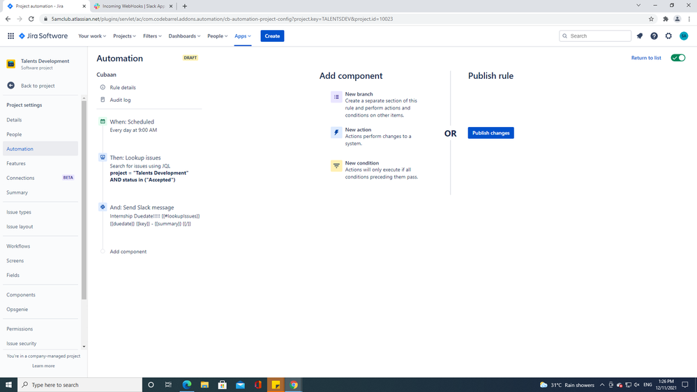

For example, an intern will end their internship on 12/11/2021. How can I set a reminder that will be send to a channel in slack 2 weeks before the internship ended.

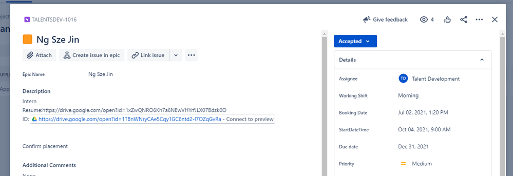

For Ng Sze Jin, the due date for internship is on 31st December 2021. So, I want a channel in slack to give reminder that her internship will ended in 2 weeks before the due date. I try to schedule the date and set it to every day. I am not sure if this is possible.

Hi @Siti Nur Atikah
You need add in your JQL sub query to filter issues based on due date. Something like this.
due >= -1w AND due <= 2w order by created DESC
I hope it helps.
Ravi

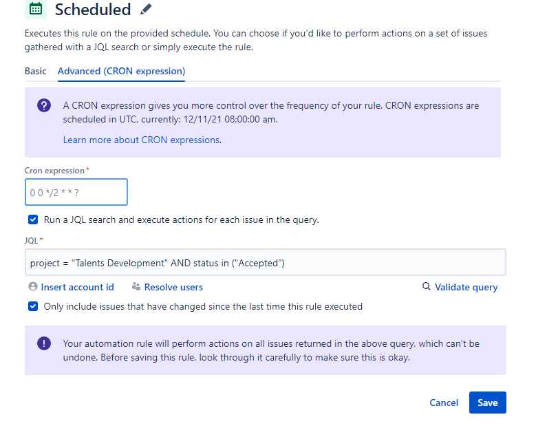

Is it the Cron expression refer for notification time?
