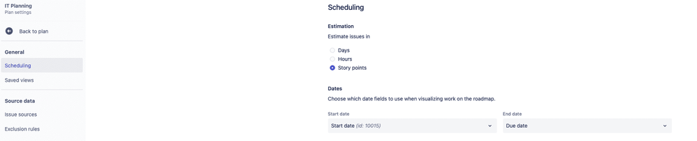

If you have created a Plan in Jira (if not you can create a plan under the plans section) you need to navigate to that Plan.
When you have opened the Plan you can click on the gear icon next to name of your Plan and then you can click on configure.
This will open the settings for your plan and you will see a tab called scheduling, inside this tab you can see the field id for the Start Date next to it under the header dates.

Then I open my Plan called IT Planning and I go and configure that Plan:
In the configure screen you can see under the scheduling tab the field id:
Under Start Date you can see "Start Date (id:10015)".
If you aren't able to recreate what I did you can try to use the given id (10015) in this instance in the hope that it might work.
