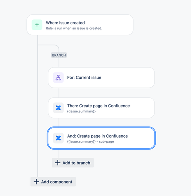

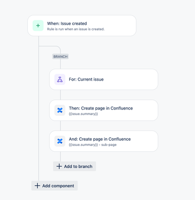

You can test this automation rule, where a page in first action is being created based on the summary of the issue, the second action is creating a sub-page and in the "Parent page" field, the page that was made from the first automation is being selected.

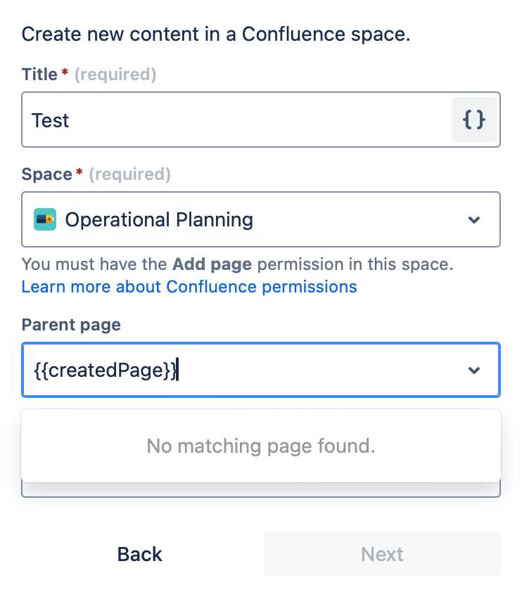

I am not able to add anything meaningful in "Parent Page".
What did you add there? I can not add any variable... I can only select existing pages... am I doing something wrong?Bildschirmfoto 2024-07-03 um 14.49.11.png
