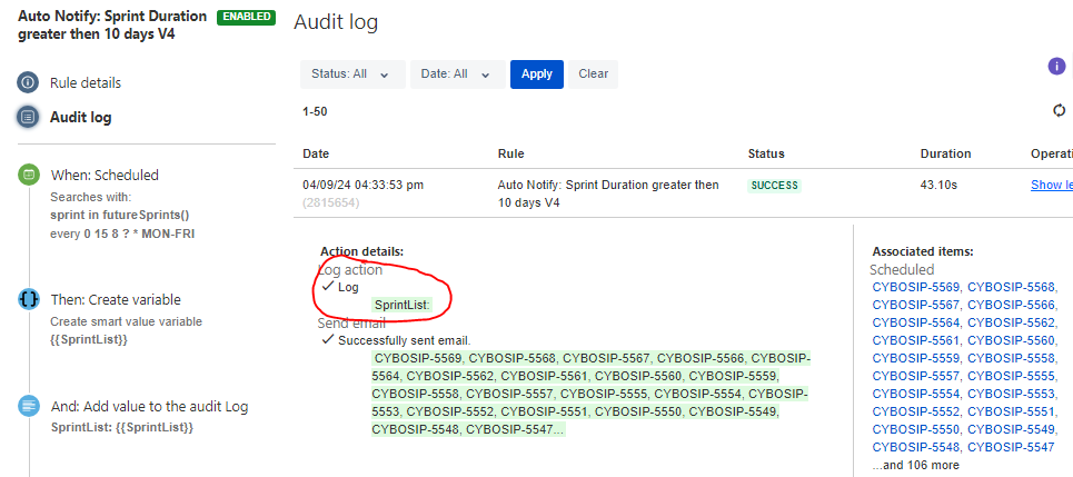

Joanna Weir
September 4, 2024
@Marc Schadee
Thank you so much for responding.  When I validate the Scheduled trigger using JQL, i get 126 results.
Here is my updated automation rule & results, per your request:
1. When: Scheduled Daily, running a JQL search: "sprint in futureSprints()"
2. Then: Create Variable called "SprintList".  Smart Value = {{#lookupIssues}}{{#sprint}}{{#if(equals(state,"future"))}}{{name}},{{/}}{{/}}{{/}}
3. And: Add value to the audit Log: SprintList: {{SprintList}}
4. And: Create Variable called "DistinctSprint".  Smart Value = {{SprintList.split(",").distinct}}
5. And: Send email .  In the content/body of the email i have: {{DistinctSprint}}
Result:
  1. This produces an empty email.
  2. The Audit Log says:  Audit Log.PNG
Please advise.

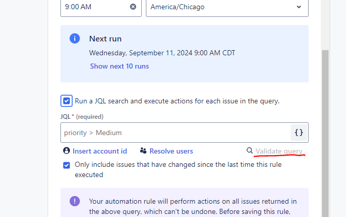

Marc Schadee
September 4, 2024
@Joanna Weir
does that return the same amount of results as the jql query?
if so
I would then move the lookup to a separate action rather than a part of the scheduled action and try again
if you do this please add a log action for the lookup as well
