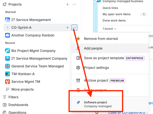

Do you have any third party apps added to your Jira instance that would extend the workflow capabilities, like Jira Workflow Toolbox, ScriptRunner, or Jira Miscellaneous Workflow Extensions?
Also, what is your project Type. Get that information by clicking on the three dots next to the project name in the navigation panel on the left.

However, the native Jira validators don't support adding conditions to say "apply this automation only if this other field has value X". --> Exactly that the point !
Im using a software projet company managed.
Im trying to do somes other stuff but unfortunately its doesnt works ... in fact i think its not possible :( i cant trigger a value inside a field.
