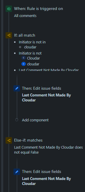

Well, it's like this:
Custom Field is set to False
  • trigger (comment is made)
  • if conditions :
    • Initiator is not X AND
    • Custom Field is not set to True...
      • Set Custom Field to True
  • else-if condition
    • Custom Field is not set to False...
      • Set Custom Field to False
What happens is this:
If matches, because the field is set to False. Action taken: custom field is now True.
Now I would (like you) expect the rule processing to stop. But it doesn't. It goes to the else-if and says: ah, Custom Field is not set to False (it was changed to True in the If block), so I need to set to False. Which was not the intention at all!
So this tells me that rule processing does not use issue data from when the rule was triggered. And that not A or B happen, but both!

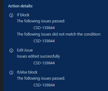

This is what the rule looked like:
This is what the execution looked like:
How I solved it:
  • if conditions :
  • else-if condition
    • Initiator is X AND
So I added a new condition to the Else-if so that it would not match the state that was created in the If-block.
I hope this made sense :)

It appears there is some image capture issue with your rule.  Regardless...the rule image you show does not match the text description of your rule:
  • the image shows two tests on the Initiator in the first if/else block
  • but the text description shows one test on Initiator and one on the custom field
I wonder if there was a problem with the initial rule conditions.

I was wrong. Explaining the whole logic to you and diving deeper into it helped a lot in finding my error :)
The first If block was not hit, because a new condition was added. And because it was not hit, the Else-if was hit, while it shouldn't have been.
Thanks a lot for your time!
