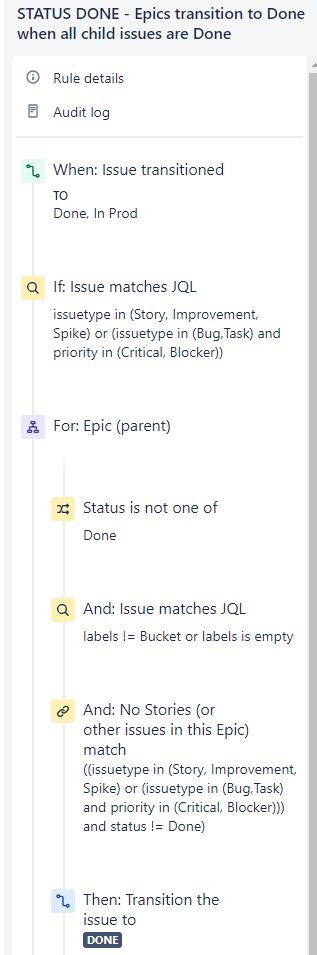

So there is already an Automation rule for the below but now I need to include issuetype-Spike in this as the Epics are getting closed by the rule even the issuetype- Spike is in To Do status, please advise.
STATUS DONE - Epics transition to Done when all child issues are Done

Can you share your full rule here?

So I have added the issuetype now on both the JQL's but if you can confirm that is correct what I did

That should work - give it a try and see.

As of now no issues so I believe this would work :)
