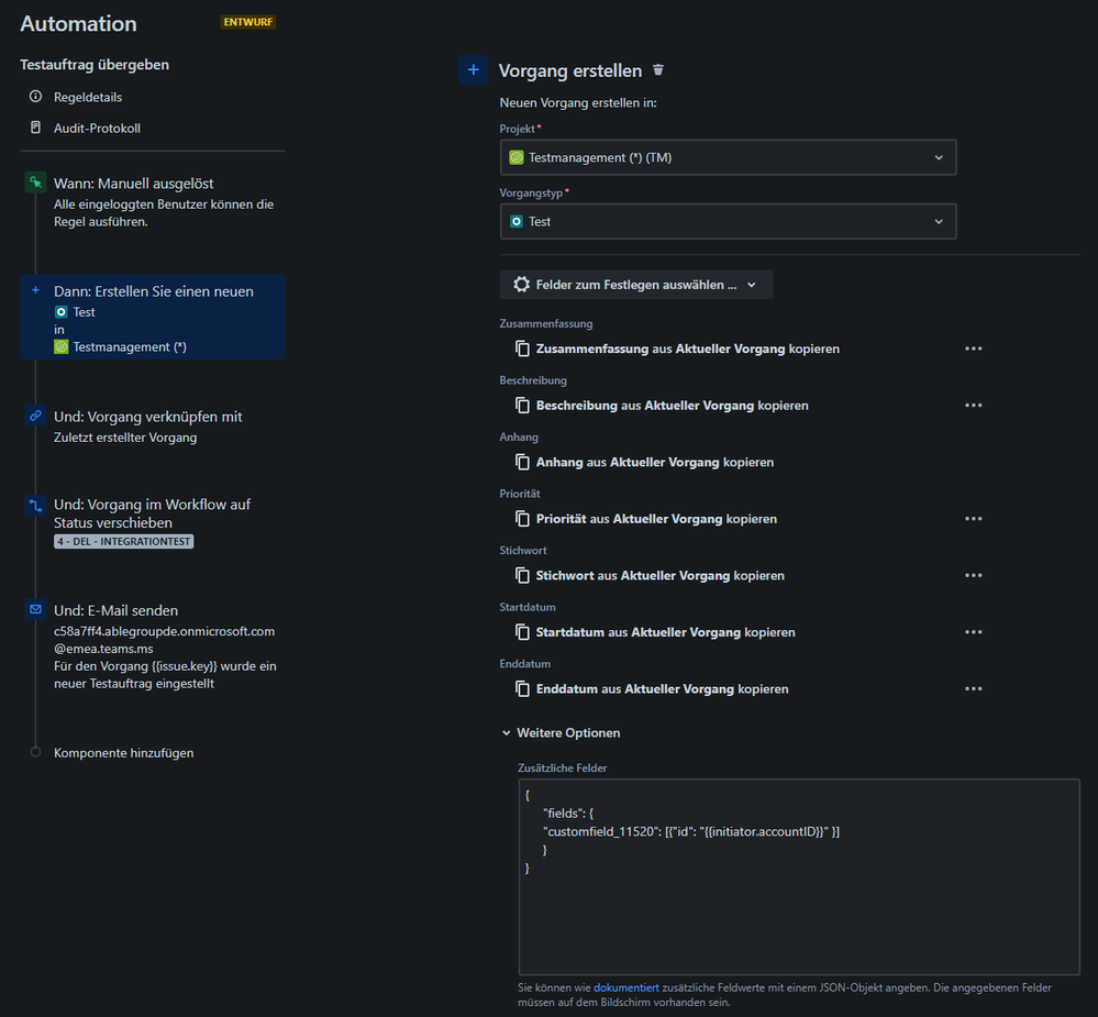

Hi there,
The attached screenshot shows an automation rule for the following process:
  1. trigger manually in project A
  2. create new activity in project B
  3. link new task (project A-B)
  4. change status for task in project A
  5. send e-mail to team of project B
  6. monitor status of task in project B
  7. if status of task in project B equals "5 - done", send e-mail to creator of task in project A.
Unfortunately, the automation is successful only up to and including step 5. The status labels are different in both projects.
I am looking forward to your tips and ideas.
Many greetings,
Christopher

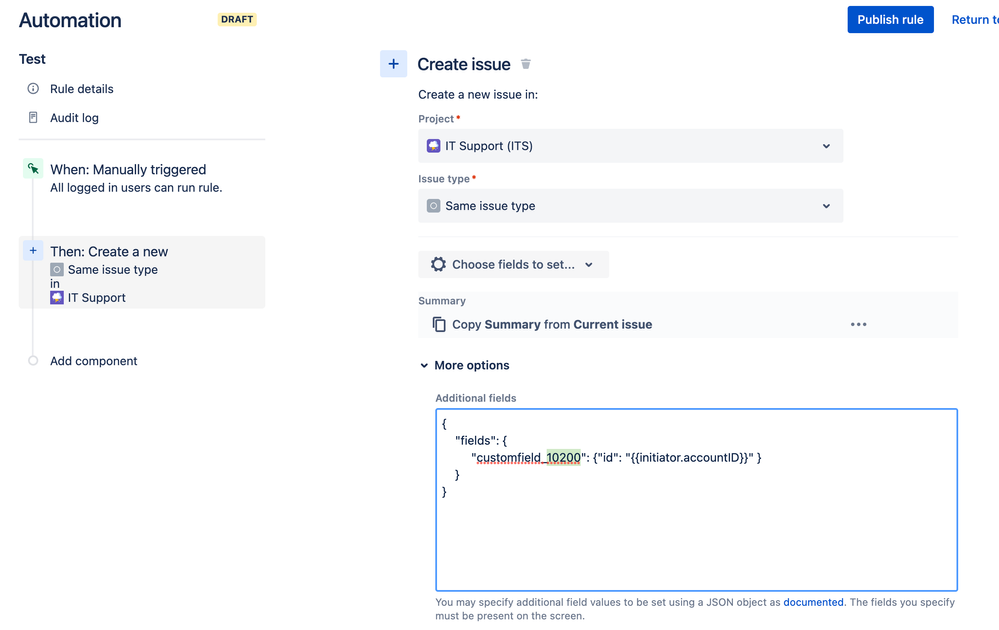

Setting the user that initiated the rule is a little tricky.
First, you need to find the custom field id, and then set the initiator in the additional fields option as shown in the screenshot below (replace the highlighted number with the id of your custom field).
You can find the ID by going to you custom field configuration, it's in the url
Good luck!
- Tessa

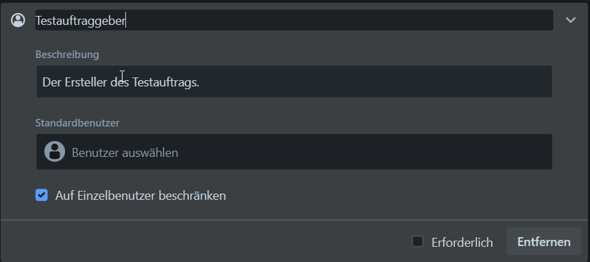

Christopher Dick
January 4, 2023
Hi Tessa,
unfortunately an error occurred:
  • "Create operation
    Error while creating the operation
    data was not an array (customfield_11520)"
Additional fields in Automation rule:
         "fields": {
         "customfield_11520": {"id":"{{initiator.accountID}}" }
Screenshot (Custom Field)
Piet Pieters
January 4, 2023
@Christopher Dick ,
this is a multi-userpicker then? The "array" tells you that a list of multiple values are expected, even if there is just 1.
Use:
"fields": {
"customfield_10003": [{"id": "{{initiator.accountID}}" }]
- Tessa

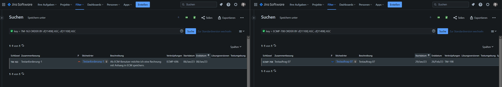

Christopher Dick
January 4, 2023
Unfortunately, the following did not work:
    "fields": {
    "customfield_11520": [{"id": "{{initiator.accountID}}" }],
    "customfield_11100": [{"id": 11100 }],
    "customfield_11498": [{"id": 11498 }]
The following error message:
  • Unknown fields set during creation. These may not be available for the project/type. Check your configuration for custom fields. Fields ignored -
    Start date (customfield_11100), End date (customfield_11498).
The fields are definitely present in both projects like this:
Many greetings,
Chris
Christopher Dick
January 4, 2023
Unfortunately, an error message occurs when copying:
  • Multiple fields found with the same name and type: .
    Start date (com.atlassian.jira.plugin.system.customfieldtypes:datepicker), End date (com.atlassian.jira.plugin.system.customfieldtypes:datepicker)
Screenshot:

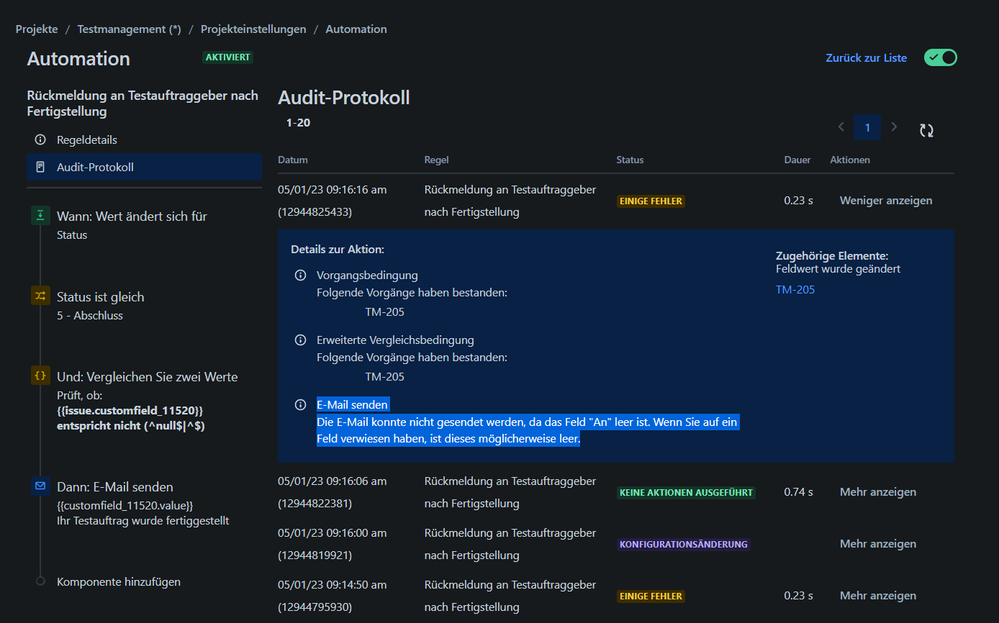

Christopher Dick
January 5, 2023
Hi Tessa,
I could already save the creator of issue A in issue B.
Unfortunately, in a new trigger in project B, I could not inform the creator of issue A by email after the completion of issue B.
I tried the following values as the recipient of the email without success: {{customfield_11520}}, {{issue.customfield_11520}}, {{issue.customfield_11520.value}}
Error message:
Send email
The email could not be sent because the "To" field is empty. If you referenced a field, it may be empty.
Screenshot:
Many Greetings,
Chris
