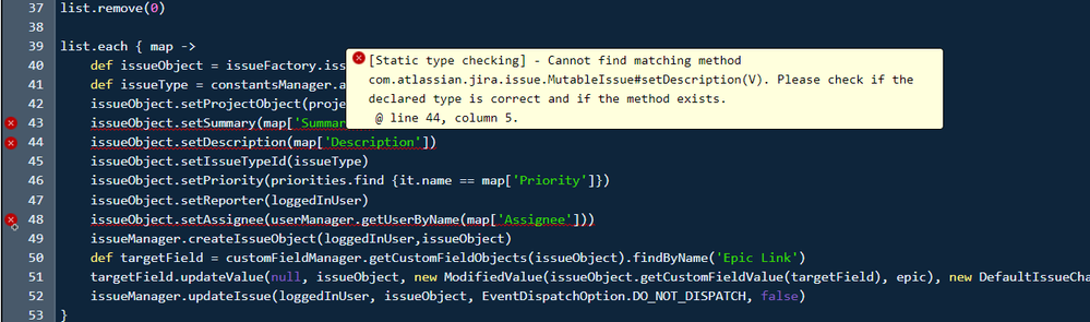

Thank you @Ram Kumar Aravindakshan _Adaptavist_ for working on this and writing the script. I am see below error
Cannot find matching method MutableIssue#setDescription(V)
Cannot find matching method MutableIssue#setSummary(V)
etc
Hi @Ram Kumar Aravindakshan _Adaptavist_
I am able to resolve it by adding .toString to the error line. I am able to create the issues from the csv now.
But my ask is that whenever the Epic is created using the component type example 'ABC' this script should run and create issues underneath the Epic.

am see below error
You are using a very old ScriptRunner editor which has its limitations. This editor has already been changed in the later versions, and the Strict Type validation problem you facing has been resolved.
Although you see that error, the code will still work. You don't have to convert it to String.

@Ram Kumar Aravindakshan _Adaptavist_ I tried play around with the code but failed to get it working and encountering different errors. As new to Scriptrunner groovy finding hard time to resolve this issue.
