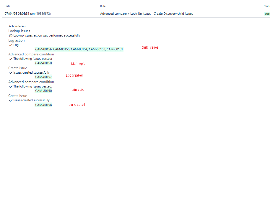

  • an image of the audit log details showing the rule execution

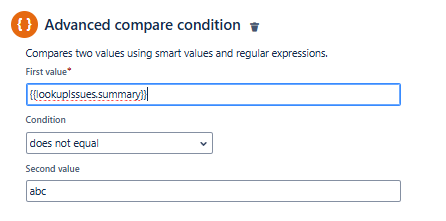

As if else wasnt working now i tried advanced compare but its too failing. Its not checking for the existing summary and still keeps on adding, that too the number of issues it got in loop up.
Looking forward for the resolution!!

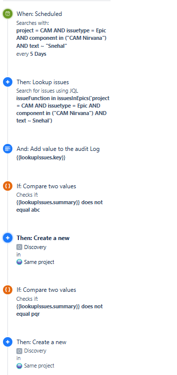

Here all the screenshots -
Complete Rule -
Advanced compare

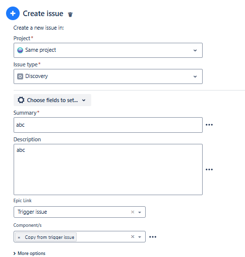

Action
Audit Log

Bill Sheboy
April 7, 2026
Thanks for the images / information, @Snehal Singh and thanks for helping clarify the scenario, @Trudy P Claspill
The general pattern of the rule you want is as below, using if / else blocks for each dependent Discovery type issue.
  • trigger: scheduled, with JQL to find relevant Epics
  • action: lookup issues, with JQL to get the children of the Epic which have a Summary containing exact match your "abc".  That is, your JQL plus the exact phrase syntax:
 summary ~ "\"abc\""
  • if / else condition block
    • advanced compare condition: check if the lookup found nothing
      • first value: {{lookupIssues.size}}
      • condition: equals
      • second value: 0
    • action: Create issue, for the Discovery item for "abc"
Now we repeat the above steps for the other Summary values, noting each uses a separate lookup issues action and if / else condition block...
  • action: lookup issues, with JQL to get the children of the Epic which have a Summary containing exact match your "pqr".
      • condition: equals
      • second value: 0
    • action: Create issue, for the Discovery item for "pqr"
  • ...and so on.
This approach is less efficient than using one single lookup and list filtering, but I recommend getting it to work first and then focus on improvements.

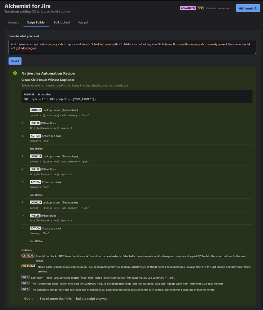

Just a little heads-up @Snehal Singh . I fed your exact requirement into our Alchemist agent:
"Add 3 issues in an epic with summary <abc>, <pqr> and <lmn>. Scheduled event with JQL. Make sure not adding it multiple times. If issue with summary abc is already present then same should not get added again."
The core problem: as @Bill Sheboy  pointed out, you need If/Else blocks. Bare Conditions halt the entire rule on the first one that fails, so pqr and lmn never get checked. If/Else blocks let the rule continue to the next block even when the condition is false.
The pattern (per summary):
  • Lookup Issues -- parent = {{issue.key}} AND summary ~ "abc" (name it lookupAbc)
  • If/Else -- {{lookupAbc.size}} equals 0
  • Create sub-task -- Summary: "abc"
  • End If/Else
Same block for pqr and lmn with their own named lookups. The screenshot shows all three:
Possible Optimization: This should also work with a single lookup that fetches all children, then three If/Else checks against {{existingChildren.summary}} does not contain "abc", "pqr", "lmn", reducing three lookups to one.
Disclosure: I'm the developer of "Alchemist for Jira", a ScriptRunner companion. I used its Script Builder and as expected it detected that your use case doesn't need a script at all. Native Jira Automation handles it.
