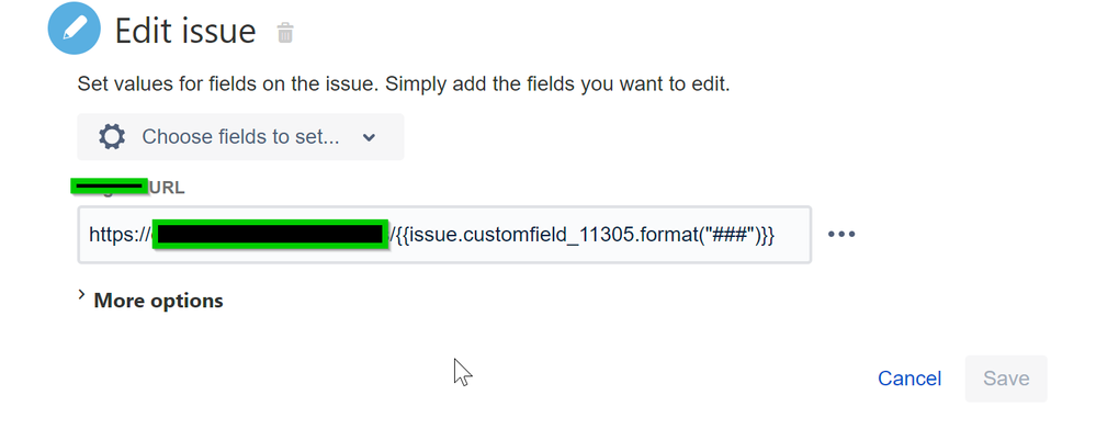

I tried .format in automation but for some reason its not working. everytime I use .format it seems to ignore value in number field
Attached snapshot of how I've configured it.

Kautilya Fadia IN
August 23, 2021
I've customfield_11305 as Number field, which by default takes floating numbers.
part with http://example.com is static, I just need to place customfield_11305 after URL like: if customfield_11305 = 11223322 URL should be: http://example.com/11223322
Simmo
August 23, 2021
@Kautilya Fadia IN , try changing the ### to a single #
That seemed to work for me
