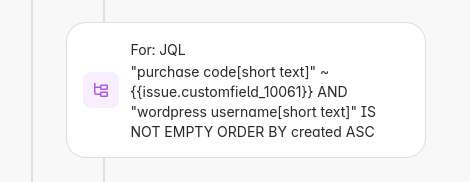

  • Option A : Using JQL in a foreach branch: it seems that I can not refer back to the work item that triggered the rule, once I am in the branch looping through other work item. My conclusion is that this was not possible.

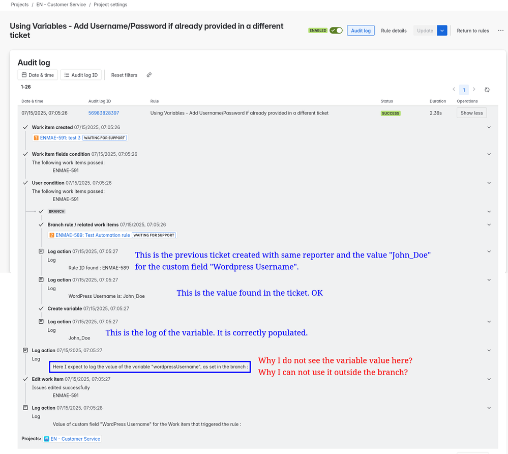

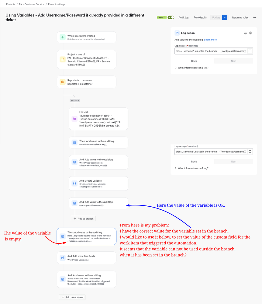

  • Option B: Using JQL in a foreach branch and create a variable that should hold the value of the custom field "WordPress Username" of the more recently created found work item, for which it has been provided. It seems that I can not access the variable outside the foreach branch. Why??
  • New Option C: Using "Lookup items". This is what I will test next.
Why is Option B not working??
Automation Rule for Option B
Audit log for Option B

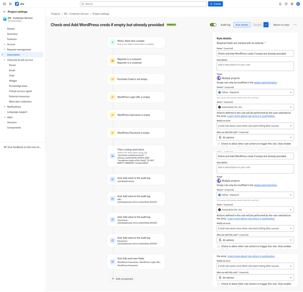

Here is my updated rule (working exactly as I need it):

Trudy P Claspill
July 17, 2025
I recommend that after the Lookup action you add an Advance Compare / smart values Condition to check that you got at least one issue back:
{{looupIssues.size|0}} is greater than 0
Otherwise you may get unexpected results or an error in the following Log actions and Edit actions when no issue is found by the Lookup.

You are creating the variable in the branch, a branch runs parallel.
The rest of the actions in the rule, don't know this variable, if you want to use a variable like this, you will need to create it before the branch.

Can I create it before (initialize it to empty for example?) and then update its value in the branch? I will then be able to use the variable outside the branch (with its value taken from the branch)?
For my specific question, the solution was the "Lookup items", but I am glad to have now a better understanding of how to use the variable. Thanks!
