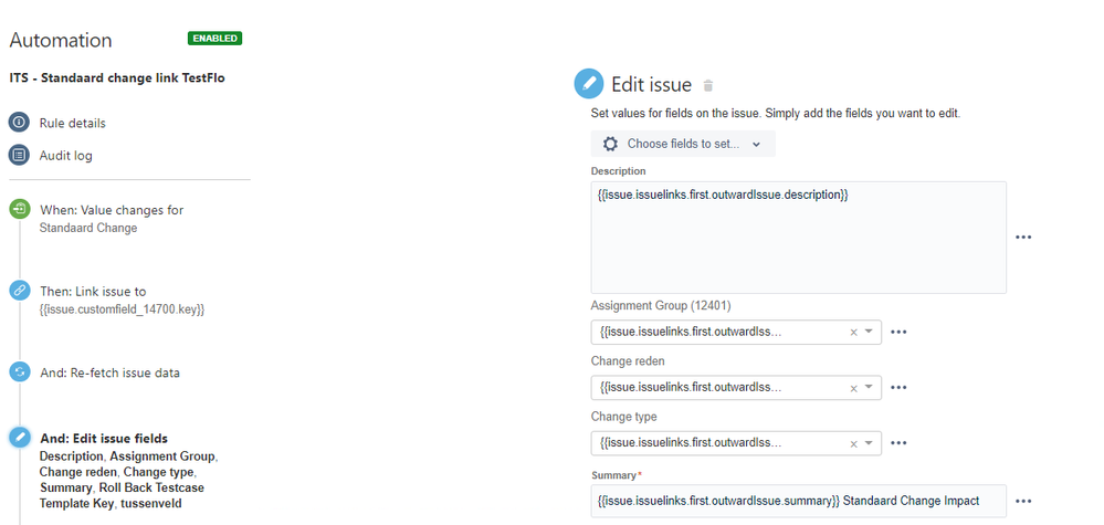

Hi,
I have an automation rule that is filled as an issue picker field, the chosen issue is linked to the issue in which the issue picker field is filled.
Then I will copy the values ​​of various fields from the linked issue in the same rule.
Using {{issue.issuelinks.first.outwardIssue.description}}, {{issue.issuelinks.first.outwardIssue.customfield_14762.key}} etc.
This works with all my fields except an Insight Custom Field.
How can I get an Insight Custom Field in this situation?
Regards, Marco

@John McKiernan Maybe a bit cheeky to mention you, but do you know a solution for my situation?   greetings, Marco

Hi @Marco Brundel
Would you please clarify what is not working?  That will help the community provide ideas.  Thanks!

Marco Brundel
November 19, 2020
Hello,
I cannot get the copying of an Insight custom field from a linked issue to work. So I am looking for how I can copy the value of an Insight custom field from a linked issue.
Regards,
Marco

Marco Brundel
December 1, 2020
@Bill Sheboy
Thank you for the information. But my problem is not that I don't know the name or value of the field, but that the " {{issue.issuelinks.first.outwardIssue"  function doesn't work on an Insight Custom Field.
So I am looking for how I can copy the value of an Insight Custom Field from a linked issue.
Regards, Marco
Bill Sheboy
December 1, 2020
Hi @Marco Brundel
I believe .first() is a function for lists, so have you tried:
{{issue.issuelinks.first().outwardIssue}}
And if you know there is only one value you can use:
{{issue.issuelinks.outwardIssue}}
