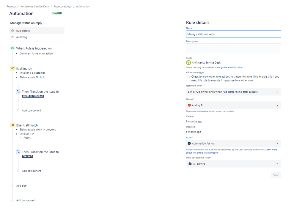

Good day everyone, maybe someone has met with this situation and can share their experiences, I will be happy to see any comments.
The situation is such, I have made automation, that when the agent answers the client and sends a comment through a line "Reply to customer", then automation changes to the status pending and in the opposite direction, when the client writes the answer from a portal or from mail, then the status changes to working, but the problem is that when writing an internal comment in the field "Add internal note".
In automation I set the first condition in the rule that "The main action is a comment", probably because of this very problem, but without this field the rule will not work.

yuriy.shilin
January 31, 2023
yuriy.shilin
January 31, 2023
Yes, this is Jira Service Management project
Mark Segall
January 31, 2023
Thanks for sharing the screenshot.  So, in your If/Else conditions, you would just need to add an additional Advanced Condition like I proposed above
{{comment.internal}}
Equals
False
This will add the extra conditional logic to only perform the transition actions when the comments are public.

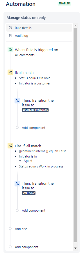

yuriy.shilin
February 10, 2023
I apologize for such a long absence!
I have tried different variants of setting, but the problem is that when you set this option stops the automation itself and when you answer with a normal comment, the system does not change the status, is it possible to solve this?
Mark Segall
February 10, 2023
To be clear, this should only be an additional condition added to your "Else" clause.  The If condition covers when the customer comments, while the Else condition covers when the assignee comments. So, you would just add the additional advanced condition I shared above to the Else clause and this should work.
yuriy.shilin
March 1, 2023
I try this, but it doesn't work

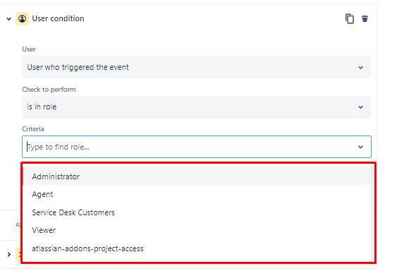

I'm not familiar with "Agent" in your Else condition.  Typically, your agents are in a role called "Service Desk Team".  You could change that user condition to:
  • User who triggered the event
    Is In Role
    Service Desk Team
yuriy.shilin
March 1, 2023
We don't have a "Service Desk Team". "Agent" is role for our support employees
