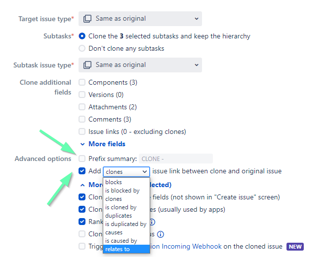

If you are not able to find a suitable solution with Jira Automation, you could try our Marketplace app Deep Clone for Jira, which - I believe - covers your use case.
With Deep Clone you can
  • Bulk Clone several issues at once
  • Remove or change the prefix "CLONE-" while Bulk Cloning
  • Change the "clones" issue link type to "relates to" while Bulk Cloning
You would simply have to
  • Filter for the issues you want to bulk clone using the advanced issue search
  • Click on the Bulk Clone button
  • Uncheck "prefix summary" and configure "Add issue link between clone and original issue" under "advanced option" in the Deep Clone Bulk Clone cofiguration.

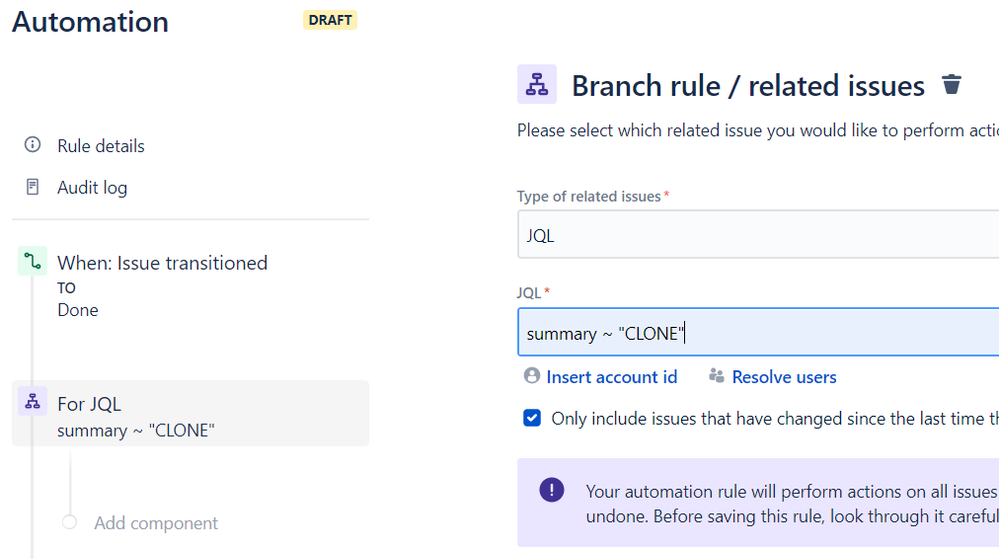

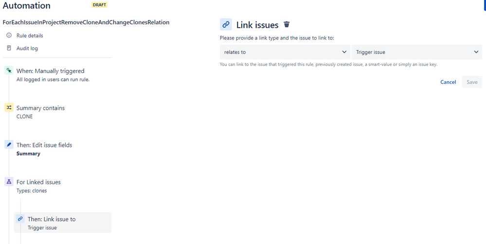

02-JqlBranch.png01-RuleForSingleIssue.PNGHi @Bill Sheboy
Tx for the quick reply. I have attached the basic rule (attachment 01) which applies to a single issue. The problem is two things: 1) the rule only applies to one issue (as oppossed to looping through all issues) and 2) in the last step "Link issue to" I must target the triggering issue (or newly created or a smart value {{lookupIssues}}).
My task is this:
For each issue in project:
  Remove "CLONES" from issue summary
  Add link of type "Reletes to" between current issue and issue it was cloned from
  Remove link of type "Clones"
My approach has been to use a manual trigger combined with a JQL branch (attachment 02). This should give me the For each -part. The summary adjustment is straight forward but when I attempt to add the Relates to -link, I have no handle to the issue that the current issue is cloned from: Trigger issue is not the issue that the current issue is cloned from and if I use the issue which was used to clone current task then that reference would be wrong in the next iteration of the look.

I believe this is still possible, and a bit risky.  First I will describe a rule to try, and then some possible issues.
  • trigger: scheduled on JQL to find the issues with "CLONE -" in the summary:
project = myProjectName AND summary ~ "CLONE /-"
  • action: edit issue fields to remove "CLONE -" from the summary with {{issue.summary.substringAfter("CLONE - ")}}
  • action: re-fetch the issue
  • related issues condition: linked issues with "is cloned by" are present
  • branch: for linked issues of the type "is cloned by"
    • action: link issue as "relates to" the trigger issue
    • action: re-fetch the isuse
    • action: delete issue link of type "clones"
Some possible risks and challenges:
  1. I have not tested this, so please confirm if the link types match your needs and are in the correct directions (e.g. "is cloned by" versus "clones"
  2. More importantly, how often do you clone the same issue to create others?  This rule would remove the link and so may fail if you have that situation.
