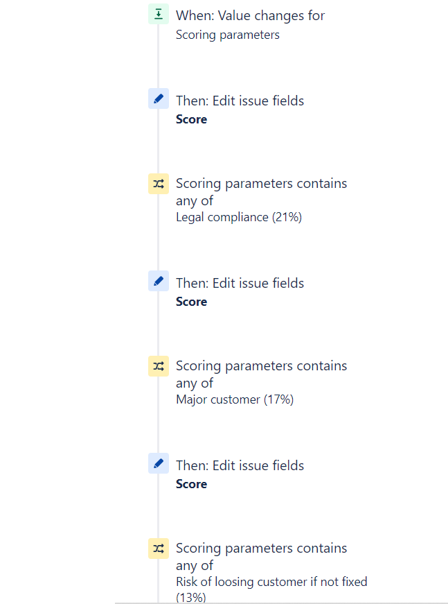

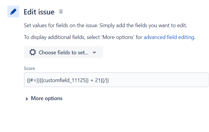

Finn Harsfort
August 15, 2022
hi @[deleted] ,
No I dont refetch issue data but also tried that without succes. But then it wont "remember" the new value for Score assigned in previous steps. I wish there was a way (using a math formula perhaps, to just assign the new value for the "Score" field based on which options are selected in the "Scoring paramters" field.
Here is a snippet of the automation rule:
The last action if for the first options and etc. for the rest
