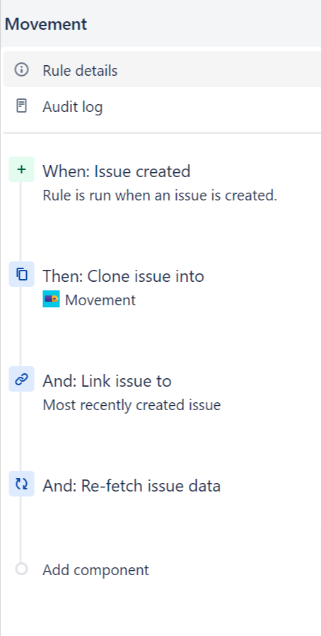

Hi Abhishek - Welcome to the Atlassian Community!
Yes, that is very easy to do with an Automation Rule. Create a rule based on an Issue Created trigger for the JSM project. Then add any conditions you need so that it only executes for the appropriate JWM project.
Then add a new action for Clone Issue. Change the project to your JWM project and any other information that needs to be added or is different from the original request.
Then add a new Action to Link Issue.
After that, same and publish the rule.
You will need to create a second rule that keeps the Linked issues in sync.

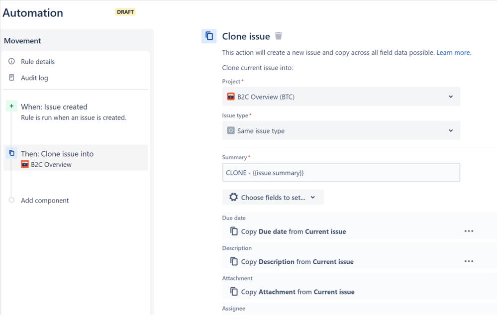

I was able to execute the first part of your answer but could not figure out how to execute the following while creating the automation rule -
Then add a new Action to the Link Issue.
Could you please guide me on how I can execute the remaining part of the automation rule that you mentioned in your answer?
Thanks in advance!

John Funk
March 7, 2023
It will look something like this:

One last question - I made a comment on a query in JSM and changed its status to "In Progress" but this change is not reflected in JWM, therefore, I just wanted to ask you if it is possible to have automatic sync between these two issues or am I looking for too much in this case?
