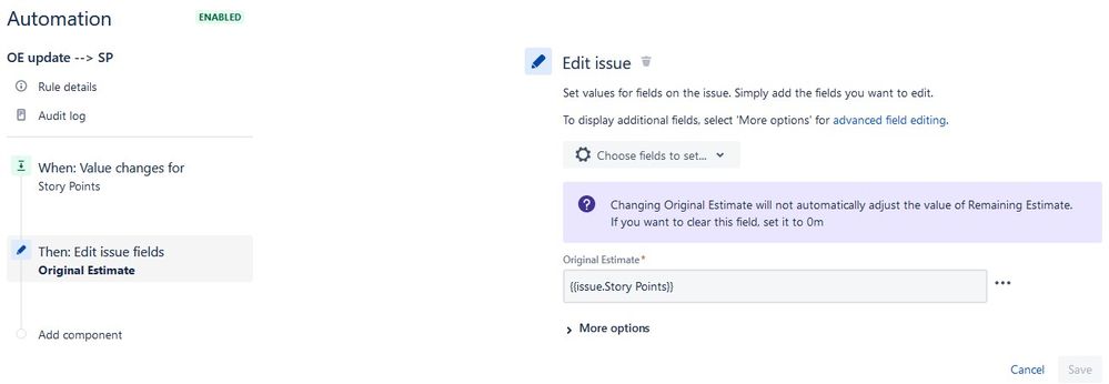

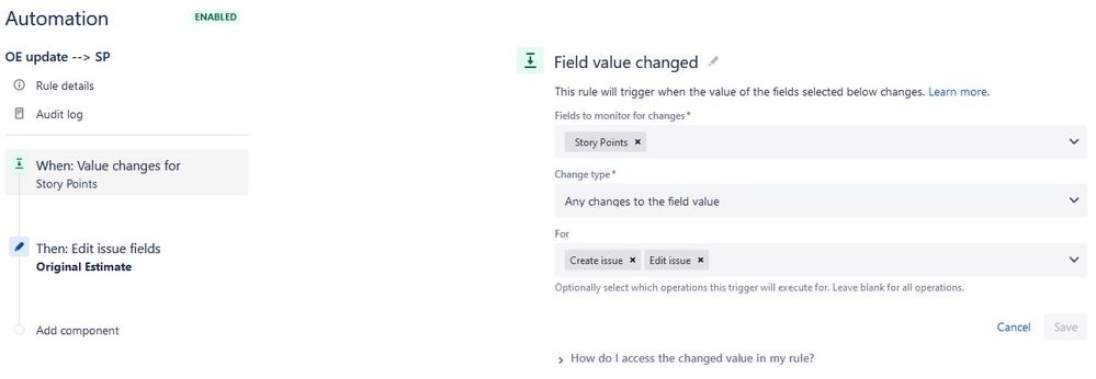

That's exactly what I try but I stock on the point that 1 Story Point should be 4h.
With this code I get 1 Story Point = 10m and Jira know that 1 day = 8h
This code {{issue.Story Points}}h give me 1 Story Point = 1d 2h (18h)
I hope that's enough informations and you can tell me what I have to write behind the code to get 1 Story Point = 4 h
Thanks in advanced :)
Hello @Maverick Schneberger
As I understand, the default unit of time for the instance is 'minute'. To handle this, please set the Original Estimate as:
{{#=}}{{issue.Story Points}}*4*60{{/}}
Here, we are converting 1 SP to 4 H; so if the story has 5 SP, it will be converted to 2d4h meaning 20 hours.
Please try this and share your feedback.

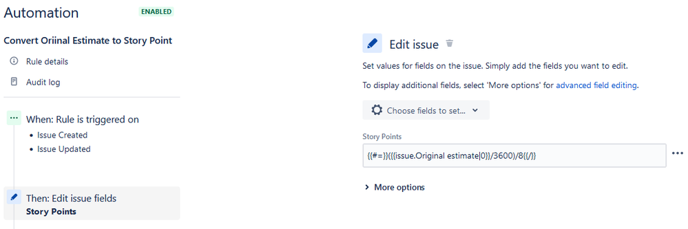

The automation rule is performing a mathematical function, explained below:
{{#=}}({{issue.Original estimate|0}}/3600)/8{{/}}
The original estimates are stored in seconds, so this is simply converting the seconds to hours. Then it divides it by 8, as you are considering 8h as 1d which equals 1 Story Points.
Hope this addresses your concerns.
@Gaurav thanks for the detailed info!
the trigger point should be whenever the field is updated, right?
@Anand Vardhan The field 'Original Estimate' does not show up in the list of fields when using the field updated trigger. To overcome this challenge, we need to use the trigger as an issue created or updated.
Hope this clarifies!!

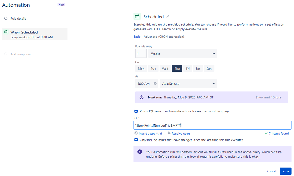

@Gaurav thanks, will keeping a schedule automation help? It would be great if you can help set this up. Ideally, this should only happen to those wherein the story points field is empy.
Also, wouldn't running the rule every time any action is taken on an issue increase the no. of executions per month?
Hello @Anand Vardhan
The automation can be set with Scheduled trigger and JQL to filter issues where the story points field is empty.
This can be executed once to cater to historic data and then it can be stopped or even deleted.
The trigger can be set as below. The schedule and JQl can be customised to suit your specific use case.
--GG

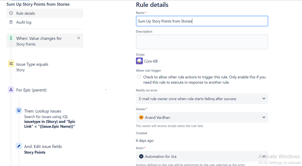

I have slightly different question. I've setup an automation which adds story points of story issuetypes to the parent epic(even in case of new addition of story to an EPIC). This is run whenever issue is updated. I wanna add Task issuetype, too. Just adding JQL condition for issuetype condition. Attaching screenshot of the automation I have set:

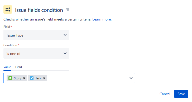

For this, the condition needs to be updated. Click on the condition 'Issue Type equals Story'.
This will open a panel on the right-hand side, enabling you to update the condition. In that, for 'condition' select 'is one of' in place of 'equals' and for 'value', start typing 'Task' and select from the list shown.
Once these changes are done, click on 'Done'
Refer to the below screenshot.
Let me know if this helps.
--GG

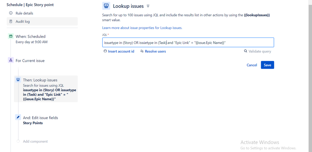

@Gaurav thanks! I have updated the following query, too. This should be fine?
There is a difference in the trigger of the rule shared earlier and now.
The new trigger will ensure that the rule will run for every Story/ Task issue type that has an Epic Link. This will cause a delay in
The precious one was precise as it will trigger every time the 'Story Points' are updated and then check for issue type. This will ensure that any updates to the Story are reflected on the Epic in real-time, well almost!!
So, I would suggest you update the rule with the best-suited trigger.
Hope this helps!!
--GG
@Gaurav Agreed, but the 2nd screenshot is for updating historic data(same think we did with the initial rule). It worked well for story issuetype but I want to include for Task issuetype, too. Just so for previously created Tasks, the story points be updated. Will including the OR condition not work?
This seems correct. hopefully, you would have tried it by now; please share if you faced any issues.
-- GG

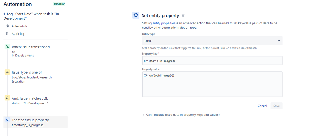

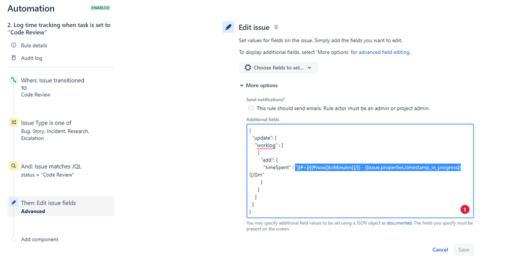

I have an automation setup for one of my projects to log work automatically based on the status change. For context, when the issue status = 'In Dev' as per below:
And then when the issue status = Code Review, this rule runs:
What I want to find out is, if it's possible to adjust this so it's only counting business days (Mon - Fri) as well as starting the calculation between business hours i.e 9am - 5pm
The automation itself works a treat, however, if a dev starts work on it on a Fri afternoon and does not set it to Code Review until Mon, then the time tracking will pick up Sat & Sun and add that to the calculation - Any thoughts?

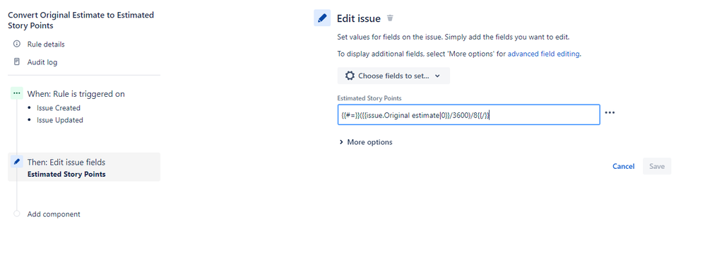

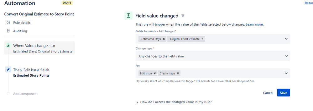

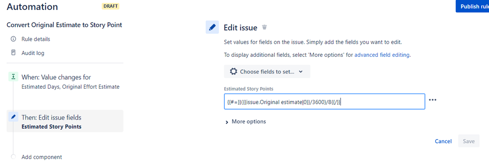

Hi @Gaurav , I found your answer to this question very good and was hoping you could help me out with a similar scenario.
We have two updated fields that will be used for reporting in our project: Estimated Story Points & Actual Story points.
The problem is, that we have multiple teams that use the 'Original Estimate' field and ignore the story point field altogether.
So, I thought, if we could create an automation that looks at the Original Estimate value and auto-updates the Estimated Story Point field, that would work a treat.
Unfortunately, I can't quite get the automation set up and running.
Are you able to assist with getting this setup correctly and also potentially provide some guidance on the best setup to update our 'Actual Story Point' field, please?
Below is what I have so far:
Hello @Allan Vaifale
As I understand, you are calculating the difference betwen 2 dates and need only the business days. There is a predefined method to do this using smart values.
The general syntax is: {{[date1].diff([date2]).[unit]}}
You can replace date1 with now, date2 with the other time stamp and unit with 'businessDays'.
Please refer to the Atlassian documentation of the same, here.
Hope this helps.
--GG
Hi @Anand Vardhan ,
The automation is pretty straight forward, just use the field change as trigger, Original estimate value or whichever field you would like to monitor and then add if/else statements based on your requirements.
The edit option will need to be added after each statement so it runs for the change
