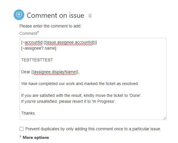

I have an automation that is adding a comment  with mention.
I'm using [~accountid:{{issue.assignee.accountId}}]
for the mention,

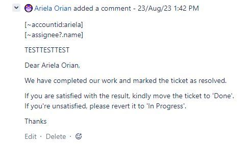

But what I get in the comment is [~accountid:ariela]
and no email is sent as a result of the mention....
Any idea what I'm doing wrong?
The action on my automation is:
and the resulting comment on the issue is:
and no email is sent :(

Ariela Orian
August 23, 2023
RESOLVED
This notation in the automation comment works -
[~:{{issue.assignee.accountId}}]
It interprets to the user mention in the issue, and email is sent as expected
