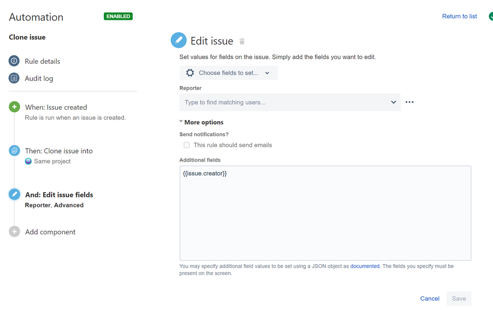

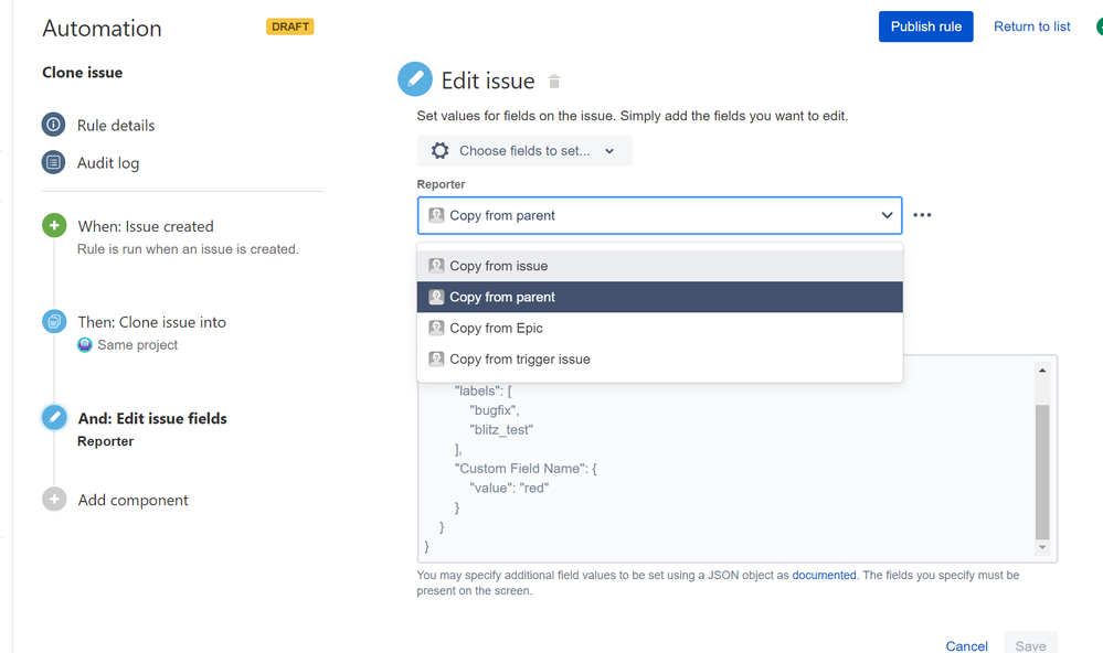

Hello,
I would like to change the reporter when we clone a task.
I went to automation and create a rule, but as you can see below on the dropdown for "Edit Issue" I don't have the option to put the reporter as the person who created the ticket.
Thanks

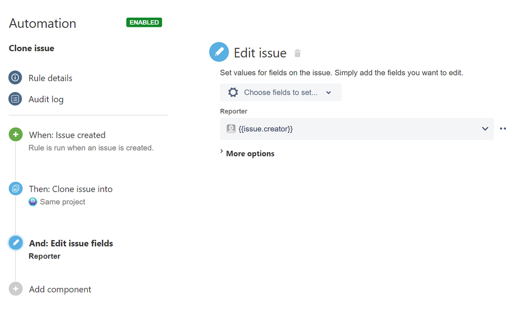

Hi @Tatianna Volamena
You can use a smart value. Reporter and creator are two separate values so you will need to use {{issue.creator}}. This should then populate the reporter with whoever cloned the issue.
Please see screenshot
Tatianna Volamena
June 1, 2022
Hi Daniel,
Thanks so much.
When a "task" is cloned, the reporter is now the person who created the ticket.
Cheers

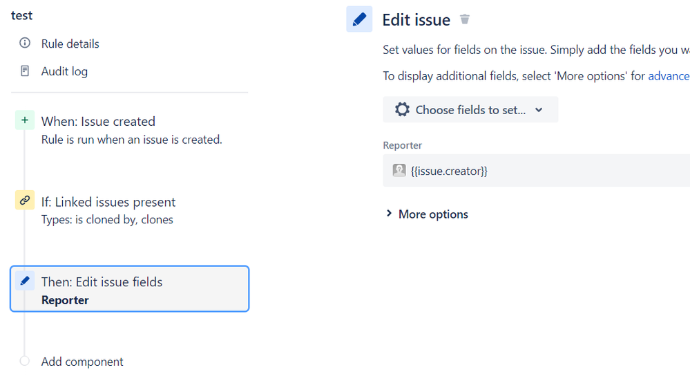

Tatianna Volamena
May 31, 2022
Hi Daniel,
Thanks for your feedback. Not sure I understand what you mean though...
I did try to do this but it doesn't work. If it is ok,  would you mind to give me details steps or screenshots to help me get the rule right.
Thanks

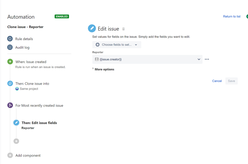

Dan Tombs
June 10, 2022
You'll need to do two things. Since you are creating the rule from the original issue  rather then the cloned issue you will need to include a branch after the clone action. Then set the branch to recently created issue.
Move the assign issue action into the branch and then in the reporter field add {{issue.creator}} rather then adding in the additional fields section.
That section is for more advance settings using JSON which we do not need to do here.
Hopefully this helps.
Dan
Tatianna Volamena
June 10, 2022
Hi Dan,
Thanks for the feedback.
Here is what I did based upon what I understood from your feedback. I did publish my changes but it still creates 2 clones vs 1.
Thanks
