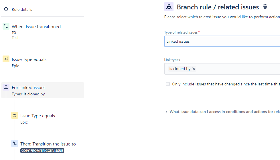

Виталий
February 3, 2022
Hi @Curt Holley
That's what I meant:
Curt Holley
February 3, 2022
So as long as the rule has Project PB (plus whichever others are in scope), you should be good to go.

Виталий
February 1, 2022
Hi,
Thank you for the detailed answer.
There is a question on the second automation "Branching - for linked issue". You can describe in more detail or show in the figure which options to select and what to specify.
On the first automation. what needs to be added so that in the task on the basis of which the clone is created, a comment was formed with a certain text from the administrator?
Thanks
Виталий
February 3, 2022
I can not understand why the rule does not return when the specified conditions are met? If I need the rule to select only epics from the project specified in the rule settings? Can you suggest what needs to be changed?
