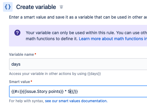

In that case you could use math expression with a smart value to get the number of days that should be added to the due date. Something like this:
And then use that as part of the smart value to set the due date like this:
{{now.plusDays({{days}}).jiraDate}}
