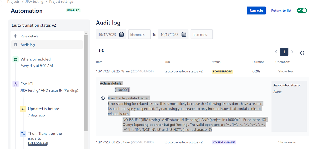

a query that is working "project = "JIRA testing" AND status IN (Pending)"

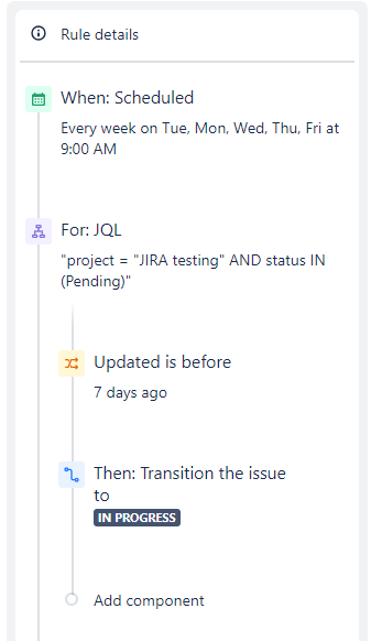

I'd suggest the simplest solution would be to use a scheduled job to run every day (or how ever frequently you need to check) ... then find those tickets which not been updated in the past 7 days and update status accordingly.
Something like the following should do the trick ....
I hope thiis helps?
Thanks,
TC.
Syed Omair Masood October 17, 2023

@Syed Omair Masood it appears that you have a typo in your JQL. Try the following:
project = "YourProjectName" AND status = "YourStatusName"
where
  • YourProjectName = The name of the project you want to get the issues for.
  • YourStatusName = The name of the current status of those issues.
Please keep the quotes for each variable.
