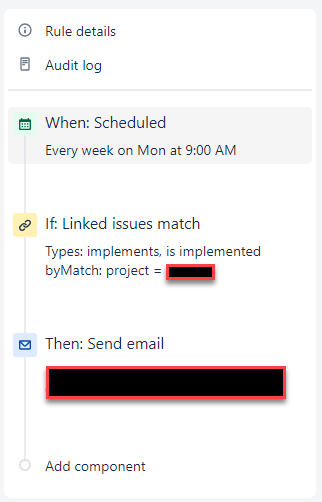

Current setup
Right now, in the "When" component, we query:
type = epic AND project = ABC and component = XYZ and label = "discovery"
 Then we use the "If: Linked issues match" condition like this to find the linked issues in the DISC project: (and here I think we made a mistake, but I can't figure out what)
Overview:
Question
The main question here is simply: is it possible to automate our request, without any usage of for example Scriptrunner or external plug-ins?
As a side question: if possible, how can I make the "Then: Send email" send me only 1 mail with a list, rather than a separate email for each Epic found.
Thanks for helping out.

Mart Postma
October 23, 2023
Hi Bill, thank you very much for the elaborate answer.
I think I will try them all and see what works best for us. Regarding to my last question, do you have any suggestion on how to solve that issue? Or is it only possible to get 1 e-mail if you subscribe to a filter, rather than using automation?
Thanks!
