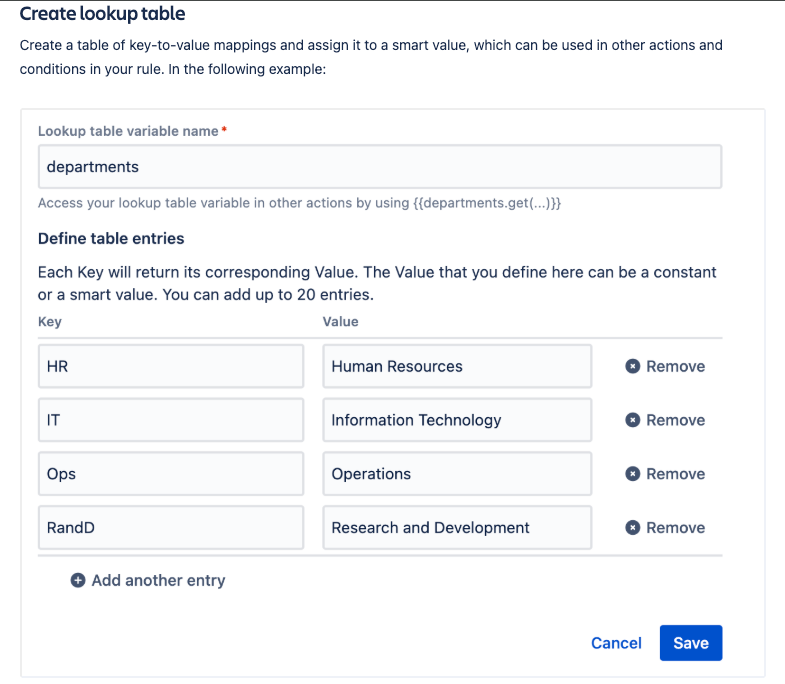

Trudy P Claspill
July 23, 2025
@Simmo
This article was published 2 years ago, but the Atlassian documentation still has an image that says the limit is 20. When will the documentation be updated?
https://support.atlassian.com/cloud-automation/docs/jira-automation-actions/#Create-lookup-table
