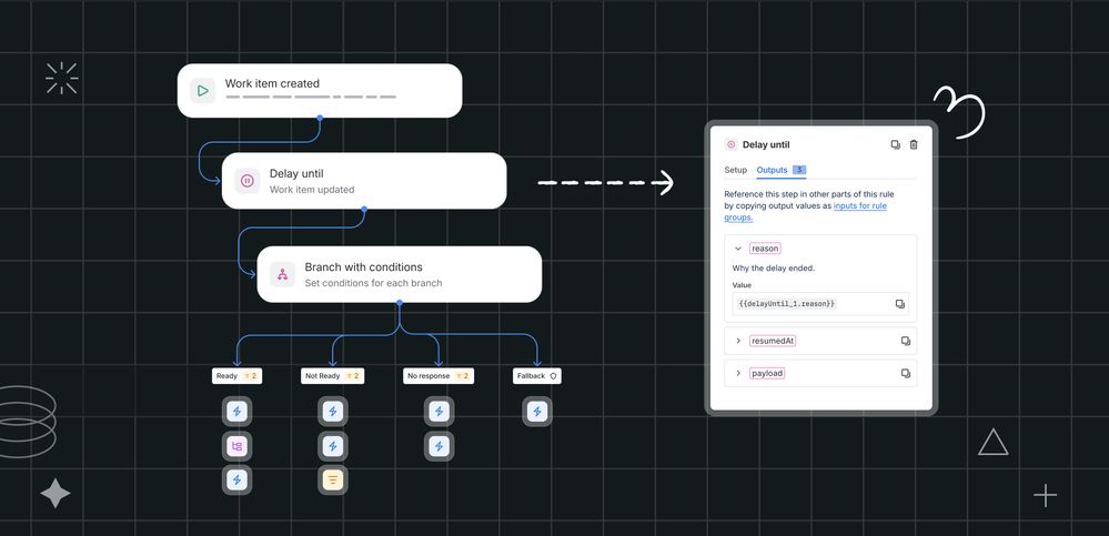

Today, we’re excited to introduce “Delay Until” Output Projections - a powerful feature that will let you know why an automation rule resumed, and what changed.
In this post, we'll walk through what Delay Until Output Projections is, the problem it solves, and how you can start using it today to build more dynamic, context-aware workflows. We’ll also share some of the improvements we’ve made to Branch with Conditions!
What are Delay Until Output Projections?
The Delay Until component in Atlassian Automation lets you pause a workflow for a specific amount of time and/or until a specific set of conditions is met. It's a powerful tool that allows users to orchestrate their workflows with precision, ensuring every step happens at the intended time.
Until now, once a workflow with Delay Until resumed, the rest of your rule had no way of knowing how it resumed. We’ve heard your feedback that this often left customers guessing or building workarounds - Did the condition get met or did it time out? Did anything even change?
Delay Until Output Projections changes that. It gives every Delay Until component three built-in output variables that downstream steps in your rule can reference, making system behaviour explicit, stable and debuggable.
Output
Description

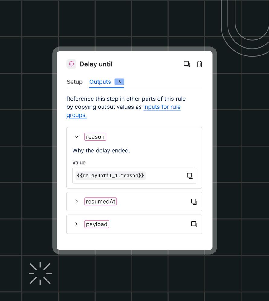

reason
Why the delay ended - whether the delay condition was met or whether the rule timed out.
resumedAt
The UTC timestamp of exactly when the Delay Until resumed.
payload
The raw work item changelog at the moment the Delay Until resolved.
These outputs are surfaced in a new Outputs tab on each Delay Until component.
To use outputs, they must be added to downstream Rule groups as inputs.
How Delay Until Output Projections work
When you add or edit a Delay Until component in your automation rule, you'll now see an Outputs tab alongside the existing configuration options. This tab displays the three output variables ([reason], [payload], [resumedAt]) with their unique IDs, ready to be referenced downstream.
In any step after the Delay Until, you can use these outputs as smart values - plug them into conditions, actions, comments, or other components to branch your logic, log the outcome, or notify your team.
The most powerful combination? Add a Branch with Conditions component directly after your Delay Until, and use the [reason] output to automatically route your workflow based on whether the condition was met or timed out.

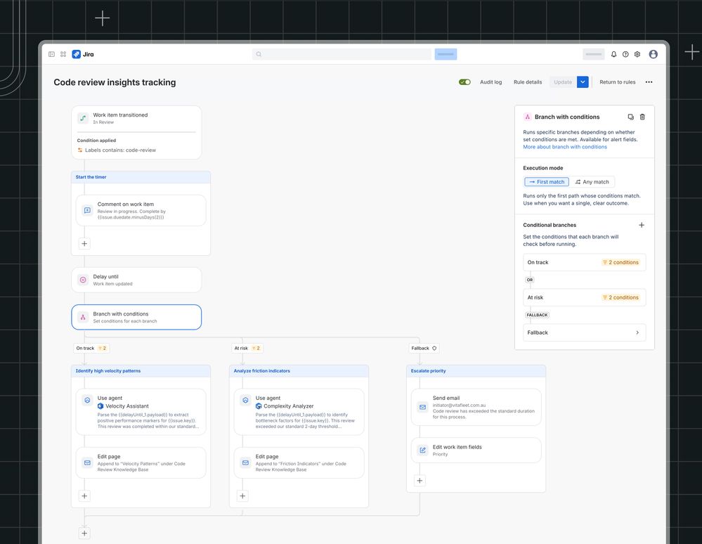

Example 1. Using Rovo agents to track context and capture insights as knowledge
Combine Delay Until Output Projections with Rovo agents for powerful context tracking workflows. When issues are transitioned, pause the workflow until it’s completed. Then, let a Rovo agent analyse the context of what happened and capture it as knowledge that can be learned from.
Use the [reason] and expressions to intelligently route what happens next. If the condition was met, inspect the [payload] to generate a summary and document what happened in the right place. If it timed out, notify the initiator and update the priority.
In the example rule below, the logic for the branches is:
  • On track branch
    • If the issue was transitioned within the due date threshold, the agent parses the payload to extract positive performance markers and then update the knowledge base with the agent’s findings for identified velocity indicators
  • At risk branch
    • If the issue was transitioned outside of the acceptable timeframe, the agent parses the payload to identify potential bottleneck factors based on what happened, and then log this analysis to better detect warning signals for next time
  • Fallback (timeout):
    • If the issue wasn’t transitioned within the set wait period, the initiator is notified and the priority is updated.
The [{{delayUntil_1.payload}}] output provides the full event data of exactly who did what at the moment the wait ended, allowing the agent to act as an informed translator rather than just guessing based on the current issue state.

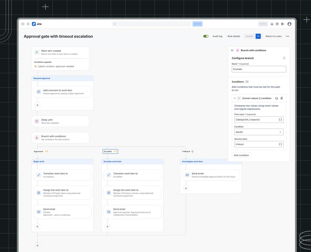

Example 2. Approval gate with timeout escalation
Pause a workflow waiting for a manager to approve a request (e.g. transition a status or add a label).
The conditions are set in the Delay Until component, and you can use the reason output to branch your workflow:
  • If [reason] = met: proceed with the approved path → assign the work, notify the team, kick off next steps.
  • If [reason] = timeout: escalate automatically → notify the manager's lead, flag the ticket as overdue, and reassign.
Using the delay’s outputs in the branches removes the need to duplicate the same conditions per branch, allowing it to inherit any changes in the conditions upstream.

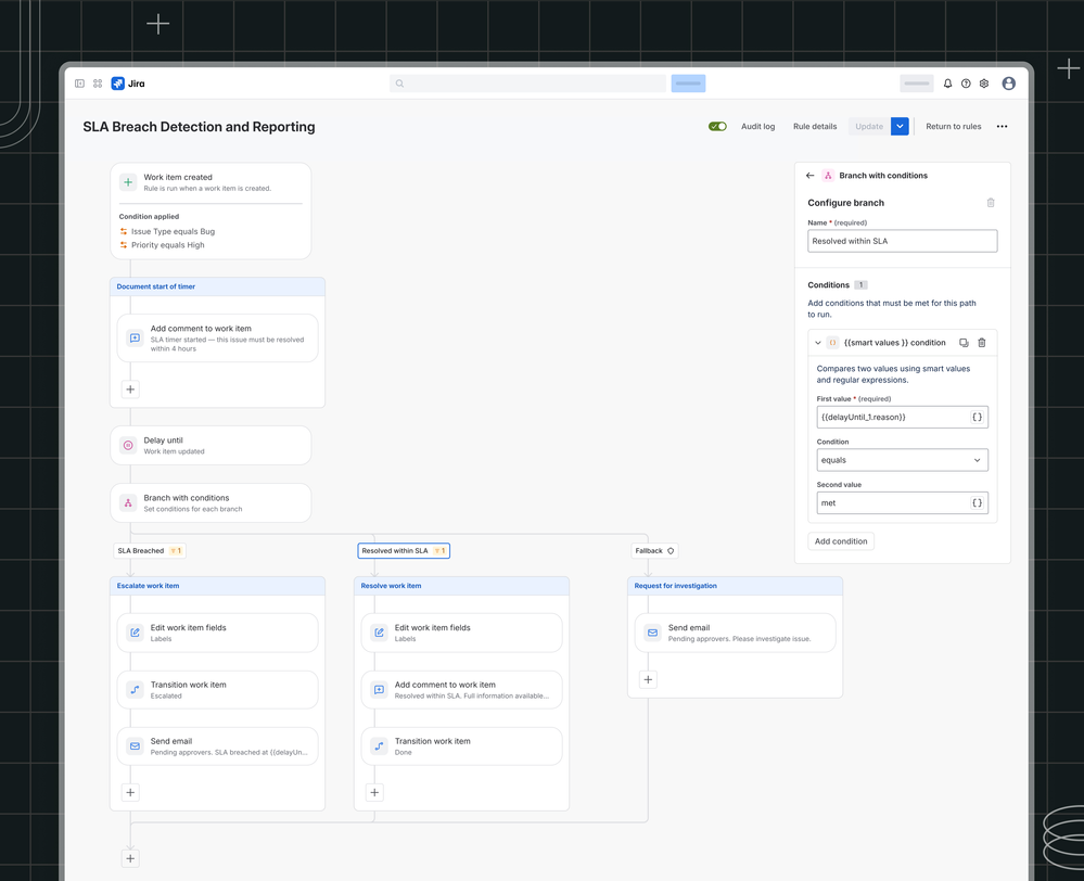

Example 3. SLA breach detection and reporting
Use Delay Until to wait for an issue to be resolved, with a timeout set to your SLA target. When the Delay Until resumes:
  • If [reason] = timeout: the issue was not resolved in time → trigger a breach notification to your team and log the [resumedAt] timestamp for SLA reporting.
  • If [reason] = met: the issue was resolved before the SLA deadline → log the [payload] . The payload captures exactly what changed that caused the workflow to resume, which is valuable in validating the flow and essential for compliance and audit log trails.

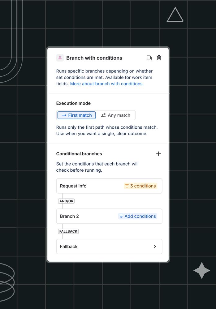

1. Execution Mode: "All conditions" or "At least one
Previously, when you set up conditions on a branch, all conditions always had to be true for that branch to run. We saw many of you ask for more flexibility, and you will now be able to choose how your branch evaluates its conditions:
  • All conditions match (AND logic) - the branch only runs if every condition is true.
  • At least one condition matches (OR logic) - the branch runs if any one of the conditions is true.
