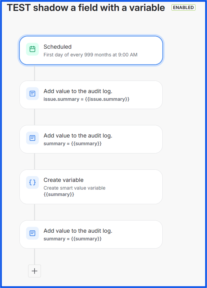

Here we have a simple rule, with a Scheduled trigger with JQL to get one work item. We write the Summary to the audit log, both fully specified as {{issue.summary}} and as {{summary}}, adding some text in front of each log write so we can tell them apart later.

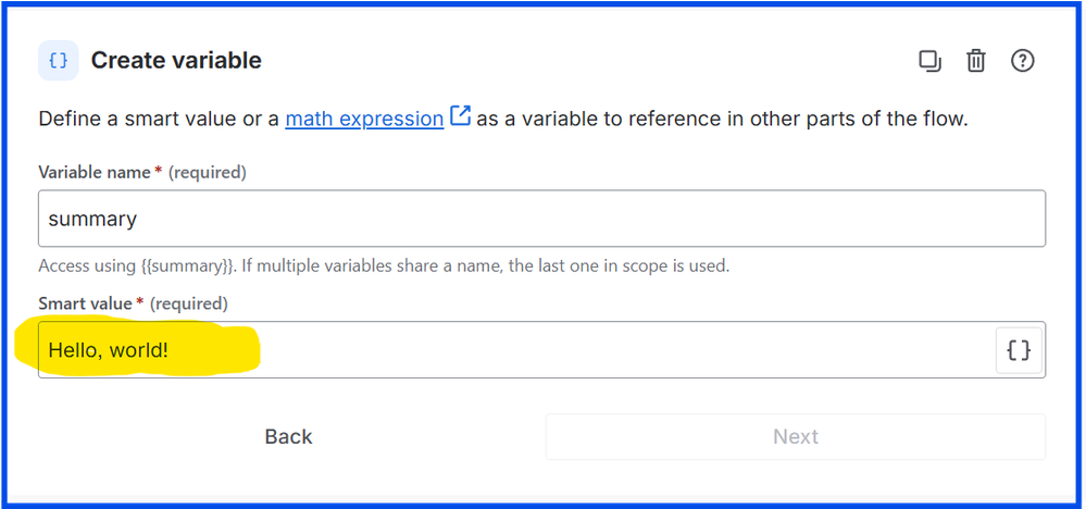

Then we use the Create Variable action to make a variable with the same name as the field, and we hard-code in a text value.
We follow that action with another write to the log for {{summary}}.

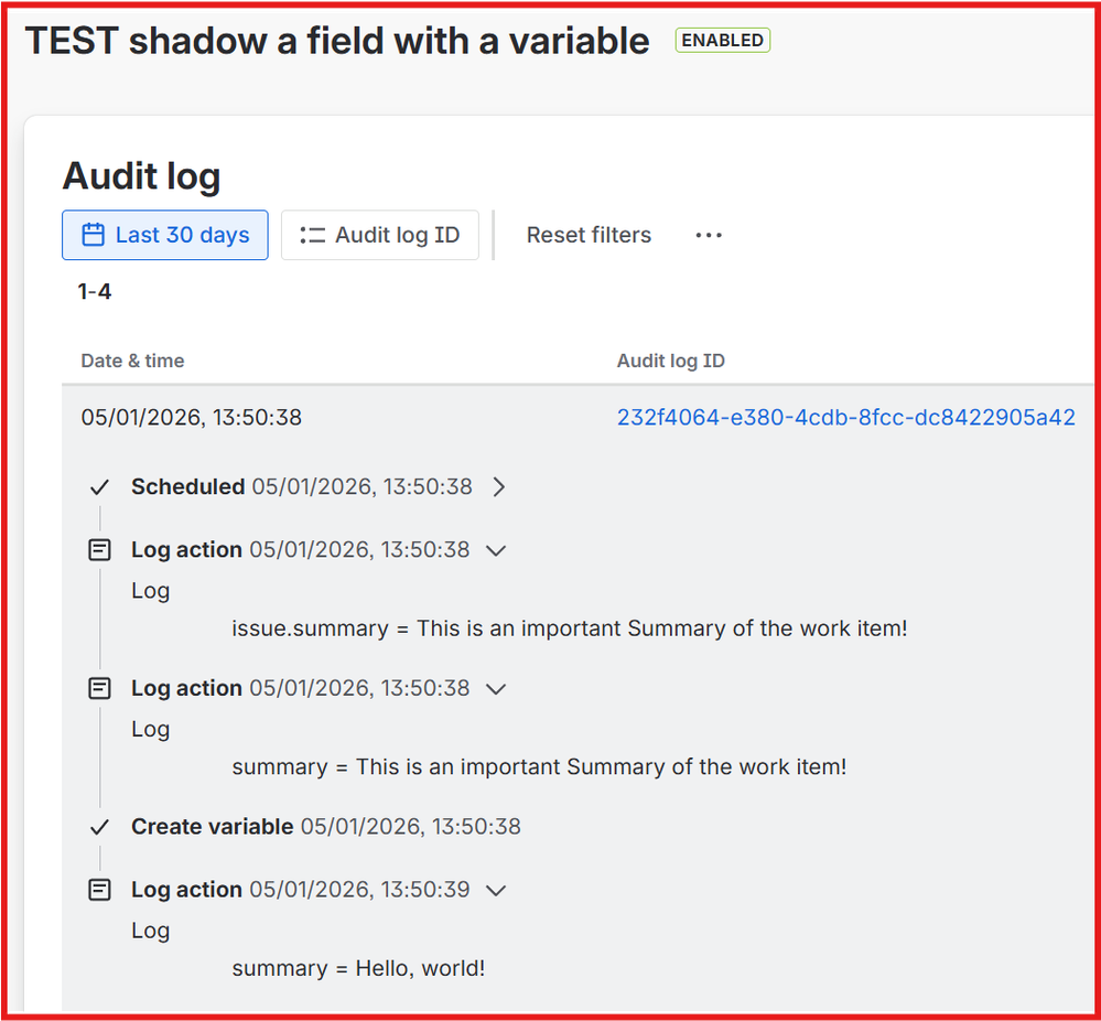

What happens when we run the rule? Here is the audit log:
Okay, what is happening here?
  • The trigger gets our work item, supplying it to the rule, and referred to as {{issue}} (and {{triggerIssue}} )
  • The first log write uses the fully specified {{issue.summary}} and has no problem resolving that to the correct thing
  • The second log write uses only {{summary}} and apparently uses an implied prefix of issue to get at the same piece of information
  • Our variable is created, effectively replacing what {{summary}} refers to
  • Finally, our last log write now sees what the Create Variable added: Hello, world!
