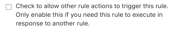

There is an option in the rule details to prevent accidently looping, and it is disabled by default to prevent looping problems. It was originally named "Allow Rule Trigger", and is currently named in the UX as:
Occasionally, we want that option enabled. One common scenario is when a field updates in a parent work item, we may want the child or linked work items to do something also. And so in a "downstream" rule, we enable the option Allow Rule Trigger so the first rule's actions can trigger the later, downstream rule. (Please note: the scenario I describe can also be solved with one rule, but that is not true with all possible scenarios.)
Additionally, Atlassian has service limits for automation rule processing. If we accidentally create a rule looping path, the automation engine detects that to halt the rule after it tries to loop more than 10 times to itself or other rules. ("To itself? I can make recursive rules?" Yes, you can...but that is beyond the scope of this article.)
Looks like we are covered: the option is disabled by default and I can enable it when I want it. If I make a mistake, the service limits will eventually protect me. Correct?
