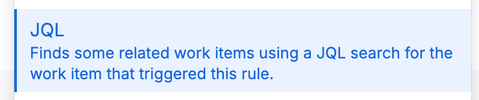

More specifically, here is the description for JQL:
Huh: "JQL search for the work item that triggered this rule".

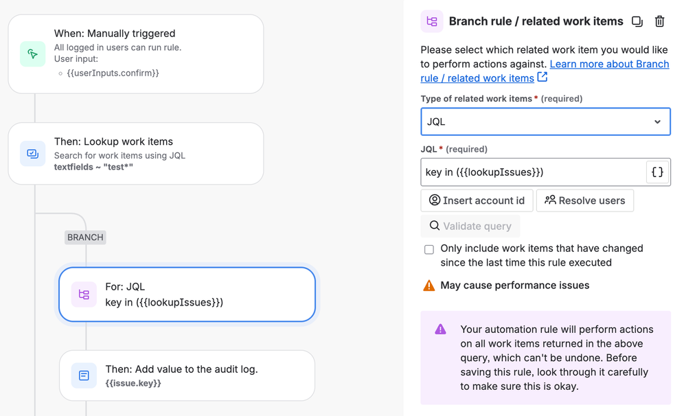

In fact I was so sure this was what was preventing my rule from updating any issues except for the one I triggered it from that met the JQL query, that I asked some Champions and @Trudy Claspill suggested I use a Lookup Issues action and then reference it in a For: JQL block with:
key in {{lookupIssues}}
Which worked as expected (pulling in all issues including the one it was triggered from).

For the record, the query I ended up using (which works, except for the excluded issue), is:
key in ({{lookupIssues}})
