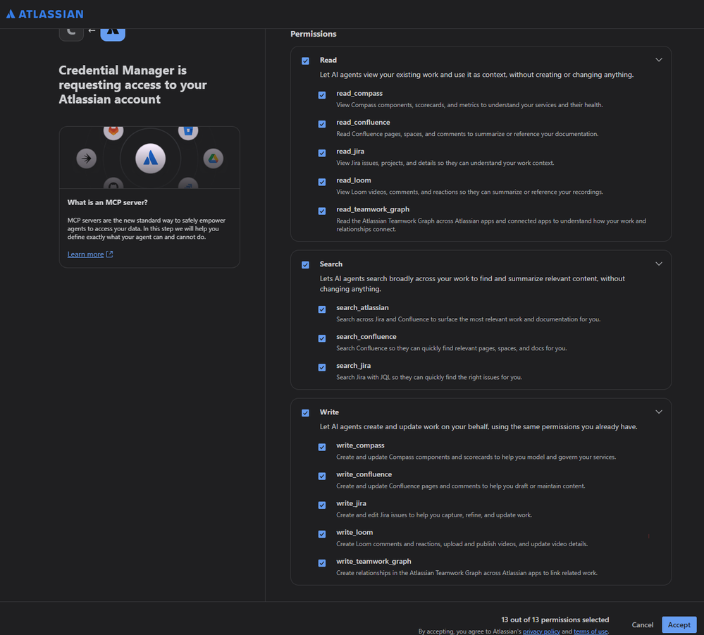

  • Revoked all prior Credential Manager grants at id.atlassian.com, deleted and recreated the MCP tool and connection in Copilot Studio, and completed a fresh consent (all 12 permissions accepted). Only one clean grant now exists, carrying only the agent-interface scopes listed above
  • The consent screen shows Read, Search, and Write all selected
The apparent contradiction
The server issues a token whose scopes are exclusively the new agent-interface set, yet the tools on that same server, including the new search tool that should require exactly search:jira:agent-interface, reject the token with "scope does not match."

When configuring your Copilot studio connections to Rovo MCP, can you please make sure authorization redirect includes the /authv2 PRM’s scopes_supported in the scope parameter, then revoke and re-consent.
i.e
https://mcp.atlassian.com/.well-known/oauth-protected-resource/v1/mcp/authv2
